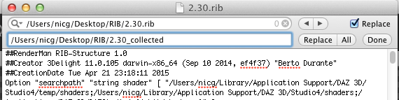

  • 404nicg404nicg Posts: 270
    Yes, Textedit works fine. That's what I use. First off, what's the path of your Temp folder and _collected folder? IF you don't know how to get the exact path, there is a trick using Terminal. First, open your RIB file in TextEdit and go to Edit>Find (or just hit Command F) Then open a Terminal Bash window and drag your Temp folder into it. This will give you the exact path to your Temp Folder in plain text. Copy and paste that into the Find line in the the opened Find window in TextEdit. Then drag your _collected folder into your Terminal Bash window to give you the path for that folder. Copy that path and paste that into the Replace With line in the Find window in TextEdit. Then hit the Replace All button and it will replace all of the Temp folder paths with the _collected folder paths.
    Ok that makes sense but in the RIB file it points to what appears to be two folders in the dad temp folder in application support
    570 x 143 - 29K
  • Tramp GraphicsTramp Graphics Posts: 2,435
    edited April 2015
    Actually, only one of those two filders is a Temp folder. Look at them closely again. The one folder says Users/nicg/Library/Application Support/Daz 3D/ Studio4/Temp/Shaders.... The second folder you're seeing says Users/nicg/Library/Application Support/Daz 3D/ Studio4/Shaders not Temp. This folder is not a Temp folder and has no real bearing on the RIB file. or the render. The one you need to change is Users/nicg/Library/Application Support/Daz 3D/ Studio4/Temp. Paste that line in the Find line, and then paste Users/nicg/Desktop/rib/filename_collected ("filename" being whatever your RIB file is named) into the Replace With line and hit "Replace All". If you hit "Replace all" it should replace every instance where it says Users/nicg/Library/Application Support/Daz 3D/ Studio4/Temp. One suggestion, however, don't put a . or other punctuation mark in the name of your RIB file ( such as your 2.30.rib) That may cause problems in Terminal Bash when you try and render the image from the RIB file. The same goes with any spaces in the fine name or folder. Instead, just use a hyphen (-) if needed (such as 2-30) Typically, however, I name my RIB files the same as the title of my scene file (with hyphens in place of spaces). Thus, In the Dojo becomes In-the-Dojo.rib for the RIB file.
    IT WORKED. I cannot thank you enough. That had me stumped for days! Will changing this also allow for batch rendering? As it was , when I tried to batch render the first render would come out but when it got to the second render textures/shading/lighting would be nonexistent

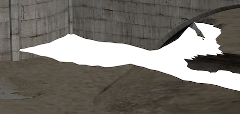

  • ScavengerScavenger Posts: 2,677
    Tramp Graphics..
    I tried your file editing idea, and it seemed to mostly work, except for one texture that didn't seem to.
    I get this error in the readout
    3DL ERROR S2050: cannot find shader 'brickyard/{4892d273-0500-4483-9e6a-f54f9d23f7c0}/shader_Surface', will use 'defaultsurface'
    3DL ERROR S2050: cannot find shader 'brickyard/{4892d273-0500-4483-9e6a-f54f9d23f7c0}/shader_Displacement', will use 'null'
    Which I assume is what the problem is, but no idea what it means or refers too.
    Brickyard seems to be a folder, but not one that exists anywhere on the computer that I can find.
    Any ideas?
    475 x 226 - 136K
    ok, brickyard is a folder in the temp shaders folder that SHOULD be put into therib - _Collected folder, but isn't.
    So one more bug in the "Render to RIB"/ Collect and Localize options.
    edited April 2015
    Any ideas?
    That's because it is a temporary folder...inside the Studio temp folder and only exists while Studio is open.
    Here's the path info for the current DS session I'm rendering in...
    /home/mjc/.wine/drive_c/users/mjc/Application Data/DAZ 3D/Studio4/temp/shaders/brickyard/{582b35de-f518-4abb-b730-4efa058b97ac}
    Ignore the Windows specific part of the path.
    ****ADDED****
    Also, check that the actual shader from the brickyard is not in the _collected older. Usually it's a generic named shader_Surface.sdl that is a compiled on the fly version of a ShaderMixer network. It's usually dropped into the _collected folder, but not as a subfolder...it should be sitting right along side of the rest of the shader files. If it's there all you'll have to do is point to the correct location in the RIB (strip the brickyard path info).
    Post edited by mjc1016 on
    The shader is probably there...but not as a file in subfolders...
    It sounds like the script to write the RIB for Macs is a bit more than broken. It may have been 'correct' 5 yrs ago, but definitely isn't any longer.
    edited April 2015
    Yup...there it is..ThnkS!
    Ok, with that knowledge, it'll be easy to do a script to make the needed changes automatically, in hopes this stuff is fixed in 4.8.
