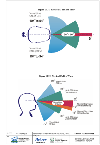

  • jpb06tjpb06t Posts: 272
    1 - we unconsciously keep moving the eyes and the head to look around;
    2 - beyond our clear field of view there is a fuzzy one which is covers almost 180 degrees!
    Both items give us a wider perception than what appears from the simple geometrical eye sizes.
    For further info see this page.
    720 x 1040 - 128K
