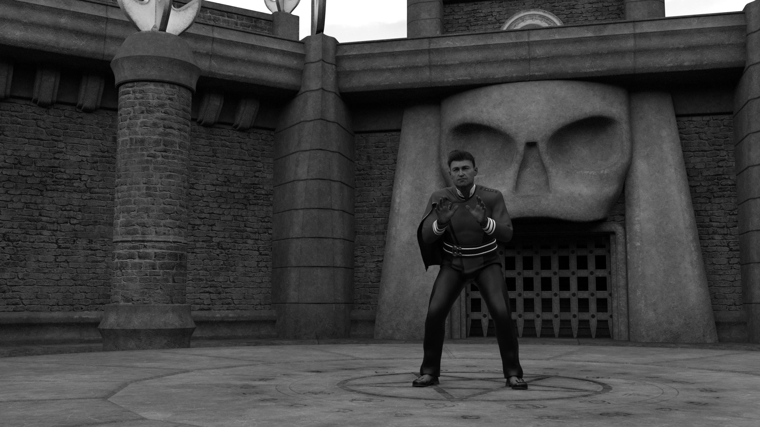

    So just for the fun of it I made a simple scene and rendered it in Iray once with saturation at 1.0 and once with saturation at 0.0, making it B/W. All other settings were the same.
    Surprisingly, the B/W render took 1/3 of the time with about 1/3 of the iterations... here is the relevant portion of the log for each render:

    B/W:
    2022-03-01 17:18:17.124 Iray [INFO] - IRAY:RENDER ::   1.0   IRAY   rend progr: Received update to 00126 iterations after 31.138s.
    2022-03-01 17:18:17.152 Iray [INFO] - IRAY:RENDER ::   1.0   IRAY   rend progr: Convergence threshold reached.
    2022-03-01 17:18:18.921 [INFO] :: Saved image: ...\AppData\Roaming\DAZ 3D\Studio4\temp\render\r.png
    2022-03-01 17:18:18.932 [INFO] :: Finished Rendering
    2022-03-01 17:18:18.978 [INFO] :: Total Rendering Time: 37.0 seconds

    And the above makes sense, if Iray has to do RGB calculations with a regular render, that means that it has to calculate once for each color, wheras in B/W it only has to calculate once. Though the 1/3 time could also be a coincidence.

    On reflection that is reasonable, and a factor of 1/3 is sensible, as each pixel has only one value that needs to converge instead of three.
