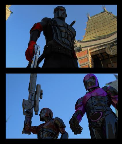

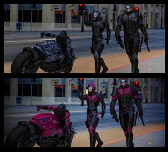

  • NoName99NoName99 Posts: 322
    edited April 2015
    I experimented with UE2 heavily a few weeks ago and posted about it extensively, including still images, in the 3delighting thread.
    My basic conclusion was UE2 is a bit dodgey, but it does work.
    Since then I've been getting pretty good results at fairly fast render times using UE2 for IBL. The three stills I've attached are 3delight UE2 renders with no additional lights.
    I'm not sure if it will help, but here's a link to the thread:
    1400 x 1650 - 370K
    1280 x 640 - 159K

    It's really forced me to squeeze what I can out of 3delight & UE2.
    Just in case it helps Here's the short form of my current workflow, it's pretty simple really:
    1) Load UE2
    2) Paramaters Tab > Color Channel - Load a .HDRI or .TIFF image into the Color channel
    3) Select the UE2 Sphere in the scene tab
    4) under the Surfaces Tab > load a .jpg that matches your .HDRI or .TIFF into the DIFFUSE COLOR and AMBIENT COLOR channels.
    5) Under Parameters, select UE2 > set "X Scale" to -100%.
    1600 x 1450 - 399K
