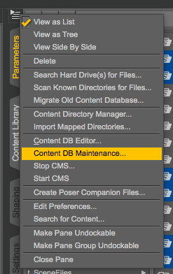

    Secondly, I think you need to do some maintenance on the content database as it is clearly pointing wrong.
    In the Content Library Tab, click in the little control meny and do as the pictures below says.

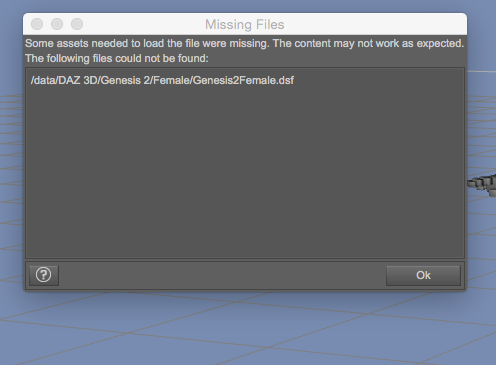

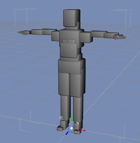

  • natclarkenatclarke Posts: 79
    Thanks. The little yellow triangles are go however I am still getting message with everything I select: e.g Some assets needed to load the file were missing. THe content may not work. The following file could not be found"
    /dataDAZ ED/ Fenesis 2/ Female/ Genesis2Female.dsf
    When I click it the genesis female is a grey square robot looking model!
    814 x 831 - 71K
  • TotteTotte Posts: 15,081
    That means that DS can't find the data folder where the info is stored.
    Please provide some screenshots of your current Content Directory setup. You find it under Preferences and the Content Librray Tab and the big button saying [Content Directory Manager...]
    , and compare what it says to where things are installed...

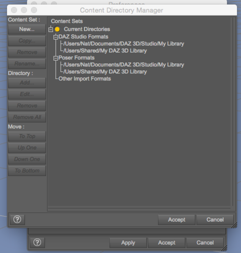

    Here are the screen shots! Also your PDF file for program doesn't open. Do you have one that works?
    496 x 365 - 40K
    482 x 506 - 69K
    You have two content directories configured, which is DIM installing to?
    I realized that and removed my documents link as all the files I copied to directory and then moved back to shared/My Daz 3D. However it is still not recognizing it. In install manage it have it set up to path shared/My Daz 3D in install manager.
    Just checked a file from fresh install and it is showing. However, I moved the whole file away and brought it back and now not recognising it eventhough it is there.
