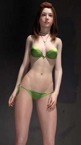

  • PUREDIGITAL101PUREDIGITAL101 Posts: 34
    So with what I have right now just use 3delight? Idownloaded Luxrender, is that worth trying? What about 3delight with macro skin? i heard its pretty nice looking.
    3d delight using macro skin
    1471 x 1070 - 432K

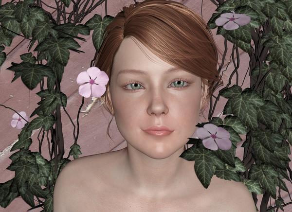

    an another example of macro skin using 3D delight and point and shoot lighting
    http://www.daz3d.com/photo-studio-point-and-shoot-2
    1080 x 1920 - 517K
