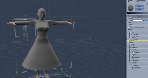

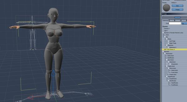

    What I am trying to do is create an editable work around for soft body cloth. I am NOT using softbody attaches to the bone skeleton. Instead, I am trying to create a set of vertex objects, parented similar to body parts, with hot points set to mimic a robotic motion of the figure. Why vertex objects? Because I want to be able to have very precise control of morphs.
    I made a "tin man" set of vertex objects that corresponded to a custom genesis 2 shape. It does not quite match up to the body parts because I shortened "limbs" and added "joints", such as shortening the forearm and shoulder, but added an elbow. The idea is that I can more precisely address the "blend" zones of figure poses.
    That was just context.
    I have two immediate problems. First, the one I started this thread for. I have created my "tin man" robotic shell. However, it would be less hassle if I could easily make sure the center of rotation for the robotic limb corresponds to the "diamond" of the bone that the limb is attached to. At the moment, I am just manually moving the hot point and trying to visually line it up in the front and side cameras.

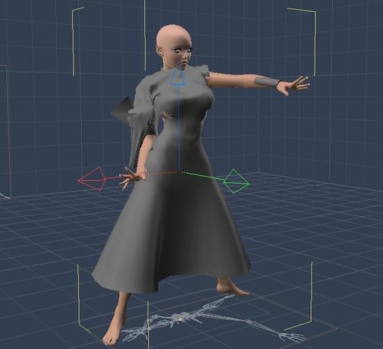

    My second problem - which is not the immediate concern - is that for some reason the test dress that I made has problems with the sleeves. The forearms of the tin man are not colliding with the forearms of the dress. Everything else seems to work OK. I tried increasing the mesh density of the forearm robot object, the forearms of the dress, and changing the "margin" setting in the soft body settings of the dress. Anyway, I deleted one sleeve just so it would not interfere with the rest of the test.
    The concept seems OK (except for the sleeves issue, which I think I don't think will be systematic).
