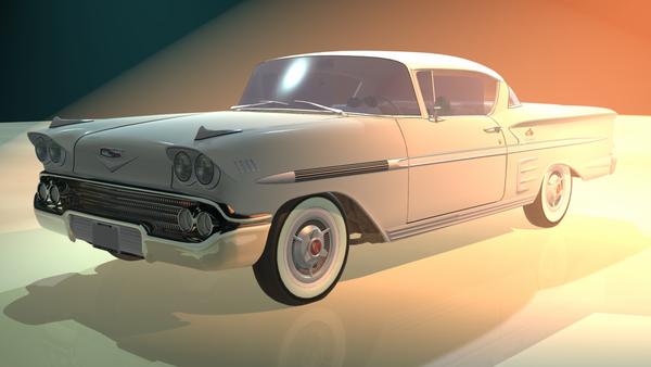

    I am trying to re-map a 1958 Chevy. Some of the textures are showing up in the wrong places and I want to align them properly.

    Several years ago I got this 1958 Chevy model from somewhere. I don't have a clue where I got it from.
    I did not build the model. I wish I knew who did so I could give them credit.
    I attached the Carrara file. Maybe you can open it and let me know what you think.
    The main reason I want to learn about UV editing is so I figure out the best way to texture room interiors with very fine details.
    I am looking into buying 3d-Coat but I would rather do everything in Carrara if I can.
    Craig

    The Chevy looks OK-ish to me, ..nothing stands out as being obviously wrong,.
    The body-paint could perhaps have more visible reflections, but I think that's because it's on a Plane with nothing else in the scene to reflect on the surface.
    If you added just a few objects (off camera) to the scene,. or use a Background image, that will add some reflections,.
    Also lower the "shininess" channel in the shader to give a wider gloss.

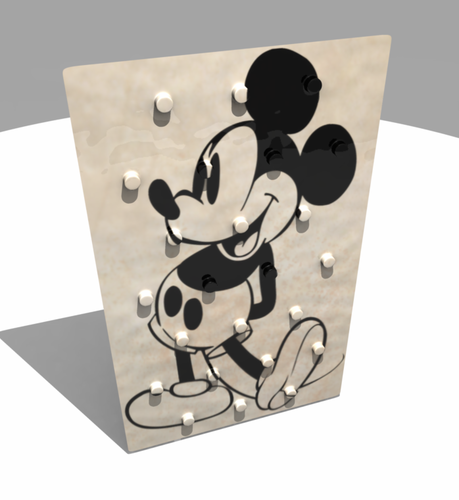

    do you use the pins on the unwrapping any of those examples?
    Thanks :)
    Thanks :)
    Hello there, well is not, I have done the texture entirely in the vertex room, in my very own experience modelling using the boolean effects can derive in some issues, here you can see a detail of the model since the vertex room:
    1616 x 908 - 235K
    i guess you'd have to 3d paint a texture?
    some of those polys are hidden behind each other

    Hi Misty whisky :)
    i guess you’d have to 3d paint a texture?
    Texture mapping is a "Projection" thing.
    it's like projecting an image onto a surface,. but the image can keep going through a solid surface (like wood) for example.
    Your UV options and layout, determine how the object is textured
    Depending on what type of UV mapping you choose to apply,. and you how you choose to layout your object, the texture can be applied to the different sides equally,. or applied to one side, and could pass straight through to the opposite side.

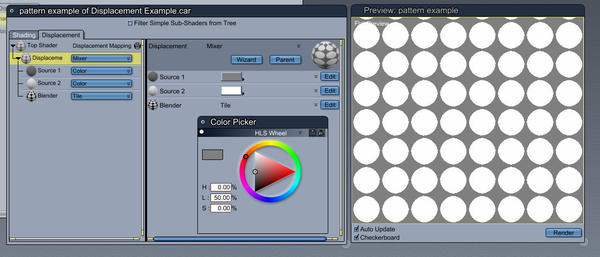

    [quote} can I create my own texture?
    yes, and you don't need photoshop or Eye candy, although they help. :)
    Carrara has some powerful shader options (see "Patterns Functions") as an example
    You can create a carrara shader in the displacement tab of the shaders

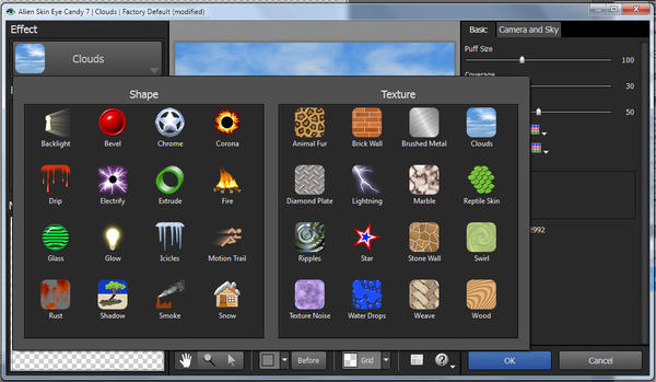

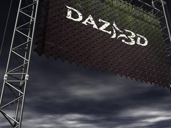

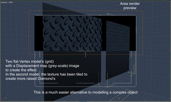

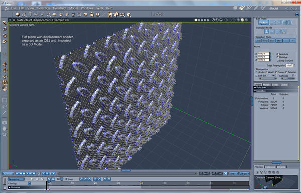

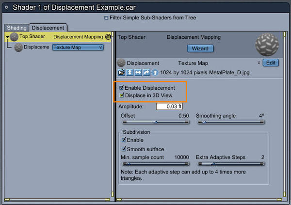

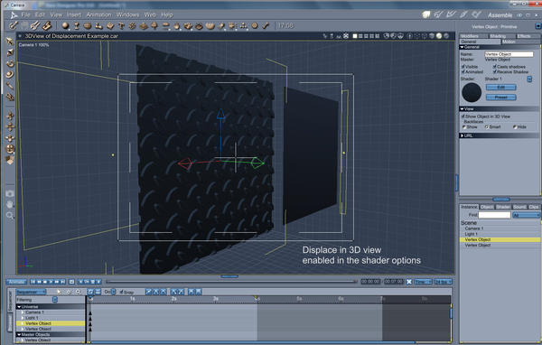

    Pics to help :)
    Pic 1 = the Eye Candy 7 options
    Pic 2 = where to enable the option to "Displace in the 3D view" in the shaders
    Pic 3 = Just an example of a pattern function, used in the displacement tab of the shader
    Pic 4 = The model in the 3D view after enabling the displace in 3D view option.
    Pic 5 = The displaced model,.. exported and re-imported as a Model without any displacement.

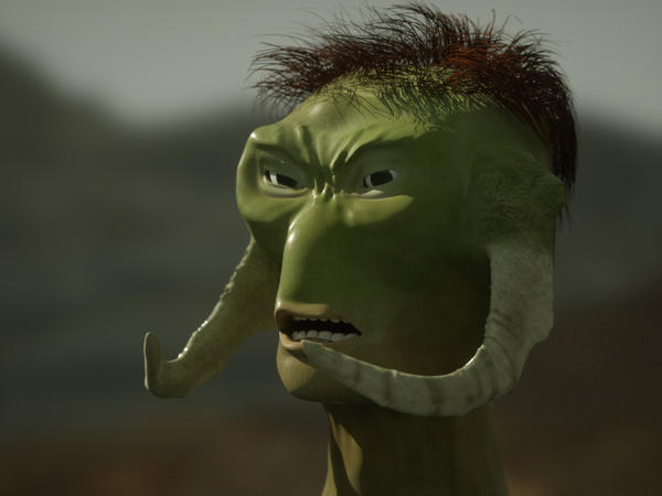

    Another way to Displace the surface of a model is to use "Displacement Painting" in the Vertex Modeller.
    You need to have several levels of sub division Smoothing or a high definition model to get good results.
    Carrara comes with a selection of "Brush" textures, but you can also create your own images to use as brushes to paint displacement.
    This allows you to "paint" the displacement strength, directly onto your model.
    You can also export the displacement you create in this way, as a grey-scale image map
    I modelled this head in Carrara, some time ago, and used Displacement painting to create a more organic feel to the surfaces like the Tusks.
    The "hair" was just me messing around with Z-brush, so please ignore that.. :)

    No way! I was going to mention that the hair looks great! A "natural" look if you ask me...
  • 3DAGE3DAGE Posts: 3,315
    Ha :)
    Natural for an alien creature :)
    The hair was the only thing on that model that I used Z-Brush for, it was really just testing the new Fibermesh and the Carrara GOZ plug-in
    the model was made in Carrara.
    I also painted that model in Carrara using the 3D painting tools, after UV mapping it in the vertex modeller
    Rendered with Octane.
  • otodomusotodomus Posts: 332
    edited April 2015
    3DAGE said:
    Ha :)
    But the result looks very accurate to me, perhaps because we are talking of a mythic creature, I don't know what you had in mind, but the result looks pretty cool to me...
