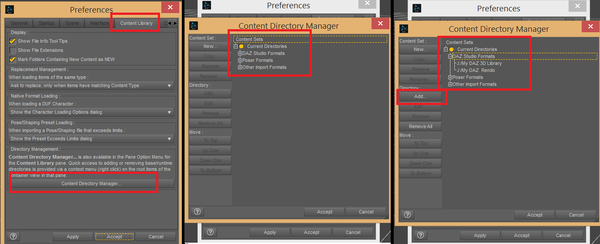

    Another issue you might run into. Don't forget to point D|S to the new install path. Otherwise all your content will be missing. It is easy to set up:
    1376 x 560 - 66K

  • VhardamisVhardamis Posts: 576
    Thank you very much for the help! It's absolutely great!
    I uninstalled my content and Daz en reinstalled it on:
    Content: D:\Users\Public\Documents\My DAZ 3D Library
    Applications: D:\bits-32
    D:\bits-64
    Somehow Daz was installed at: D:\Program Files\DAZ 3D\DAZStudio4 ????
    I changed the old paths in Content Directory Manager like in your Decription Vhardamis, but many content files are searched by old paths like in the C-Directory again.
    Are there more settings in Daz to change, or do I have do uninstall again?
    Greetings
    Gordon
    The program itself will be in the program file. All the content will be in the folder you created When pathing to the content you need to add a file under all 3 tree for format types.
    so Daz studio formats add path to
    Poser formats add path to
    Other formats add path to
    This should have everything show up in your content library tab. Bear in mind not all purchase will show under the smart content tab but they should all appear under the Library one as file folders (you may or may not get thumbnails as you expand the folders)
