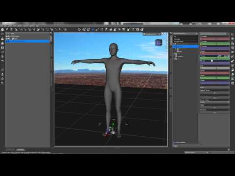

    Here's a video that covers the differences between Iray and 3DL,so it might help you:
    This might be useful for you, too: https://www.daz3d.com/3delight-render-engine-tutorial-workshop

    For the HDRI part of my question, here is another video.
