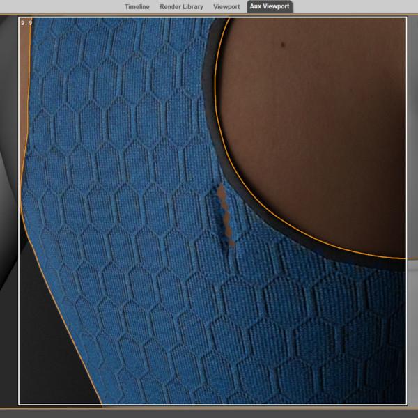

    Quick n' dirty displacement map indentation.
    I used the Tank Top for G8F located in Genesis 8 Starter Essentials > Wardrobe, for this.

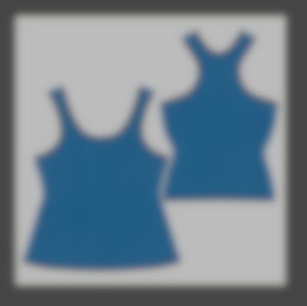

    3. Copy one of the maps that shows the UV lay out well enough to see where you need to work. I used the Base Color map of the Basic Wear Tank Top. [If you don't know how to do this; Go to one of the little boxes to the left of the sliders that has an image, mouse over it and take note of the file name. Now click on the box, go to browse, locate the image and copy it, close the window and save the file someplace where you can find it again.]  It should look something like this.
    Save it someplace where you can find it again.

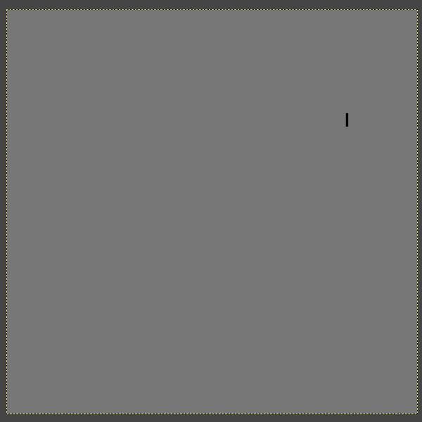

    4. Open the map in an image editor that supports layers. (I used GIMP.) Create two new empty layers on top of the image you just opened.

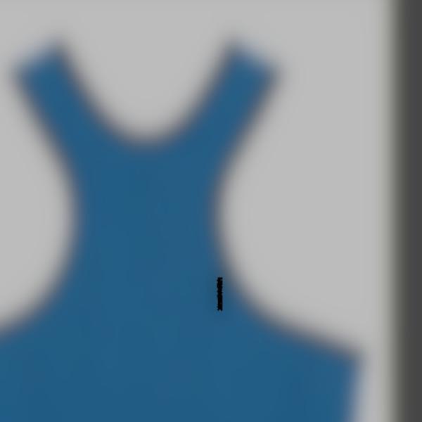

    5. Select the top layer, locate the area on the image you wish to displace and cover it with pure Black. (I used select and fill.) Save it someplace where you can find it again.
    5. Select the layer below the layer you used black on, and fill the layer with neutral grey. (It should look something like this.) Save it someplace where you can find it again.

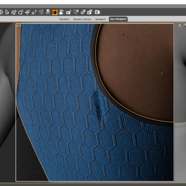

    9. Displacement WILL ONLY be visible in Iray preview / spot render / render. Check and see if it is working. It should look something like this.
    10. You should notice that the entire object been displaced (slightly expanded). You will need to compensate for this by using the displacement channel values, or in this case the Tank Top fitment sliders worked as well.

    8A. Displacement WILL ONLY be visible in Iray preview / spot render / render. Check and see if it is working. It should look something like this.
    9A. You may need to adjust the displacement channel values to get the results you want. ( If you go this route I strongly suggest you take note of the original values so you can revert back.)
