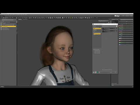

    Any of the Toons by 3DU ,or heads that are larger than the "normal"  ......
  • Zev0Zev0 Posts: 7,123
    I don't have a lot of 3DU characters, but I did a test here using one.
