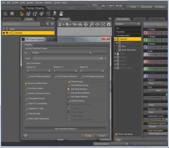

If I take a figure in DS, and export it to OBJ for Hexagon with groups (Write Groups -> Use Node Names, so that I can select and modify the part I want to work with), I cant seem to then save it back as an OBJ that DS will allow via Morph Loader Pro. (Geometry not matching)
I know there must be a trick to this, but I don't know it. I've tried the merge groups on save to Obj but that did not work?

    For OBJ export/Morph Loader import, you need to set Genesis to Base Resolution.

    Yep, I have that set...here is a picture of my Export from Daz Settings. If I do "not" check the groups option, then this all works fine.
    The import/export options in Hex I leave everything unchecked.
    (...and I have tried unchecking "Ignore Invisible nodes" and still same results)

    Appears to be a vertex order issue, I got it working in Blender instead.
