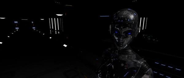

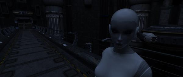

I was trying out the iray feature and it doesn't seem to 'see' metal surfaces/lights. I attached the same picture done in two different renders. The top one in 3Delight and the bottom Iray. The Iray render took over an hour. 3Delight less than a minute.
As you can see, the Iray render seems to remove the metallic chrome on the robot and the lights no longer 'glow' like in 3delight.
Is there a setting to fix that? I messed with a few settings that don't seem to work.
Thanks!

  • KhoryKhory Posts: 3,854
    Did you apply Iray shaders to the surfaces? If not Iray may not be reading the surfaces as well as you may want. There are a bunch in the shader preset/iray uber shaders file. What sort of lights did you use? Iray emmisvie does not appear to be on the same spots that glow in the top render.
  • cd832cd832 Posts: 10
    I just tried applying an iray shader to the figure, but it doesn't seem to work, unless I'm doing it wrong. I also tried to 'merge' an iray shader into the scene.
    I used one spotlight to light the scene (figure). Would I have to apply a shader to each surface that's part of the scene? Still. Doesn't seem to be working.
    Thanks for the help.
    Hrmm.. the metal should have applied to the figure with no issue. If you wanted to retain any bump or displacement you needed to hold down the ctrl key. If there is a map in diffuse and you add a color that may make it a bit squirly.
    Be sure your adding the correct kind of light. None of the 3delight lights will really work properly with iray so you need to be sure to use the photometric spotlight. That can also be used as a "mesh light" by changing it from point to one of the shape options. The size is adjustable and a larger size will give you softer shadows.
    If the space is enclosed then your going to need lights that fill the space. You may need more than one photometric light. If the "glowing lights" are a separate surface you can change the material to emisive uber iray shader. You may want to change the color temp on that to 5500 or 6000 to have it be similar to the color in the first image.

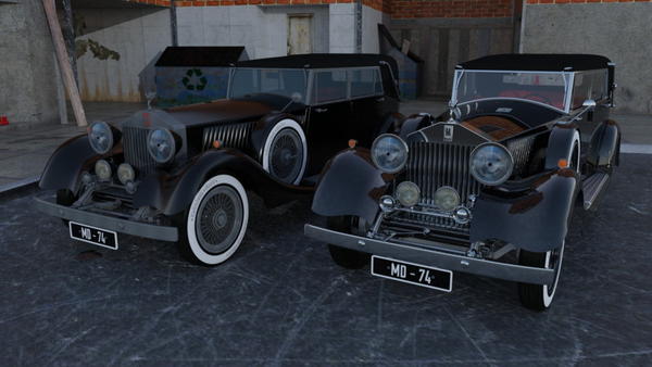

    For metal surfaces in IRay, first select the surface and apply IRay Uber Base shader.
    Then you can turn up metallic to make it behave more like metal, or if it is a plain surface without other texture elements in it, apply one of the IRay metal shaders. I did a little test in IRay using a car. One is just the default 3Delight shaders autoconverted, the other has IRay shaders on it.
    1000 x 563 - 131K
