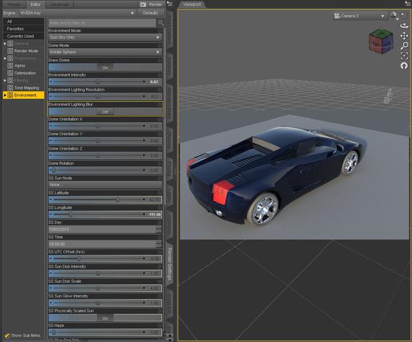

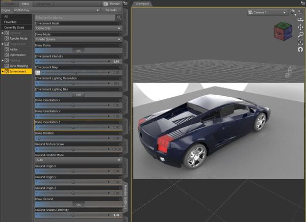

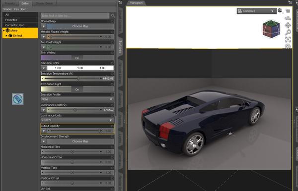

  • Takeo.KenseiTakeo.Kensei Posts: 1,303
    If you use DS 4.8 beta and Iray there is an easy setup with mesh lights for interior
    1°/ create a cube (10 meters) that will contain your car and adjust the diffuse color (I chose a grey)
    2°/ create a plane (10 meter) and place it above the car
    3°/ Apply Iray emissive shader on the plane and adjust light temperature and luminance as you wish
    I also configured render environment to "scene only"
    You could also add some other little meshlights or photometric lights if you want from that point
    Otherwise you could use HDR map to light the scene. in dome mode and let the magic of the HDR do the job
    Finally you could also use Iray's Sun and sky
    1119 x 928 - 138K
    1114 x 809 - 129K
    1134 x 730 - 106K
