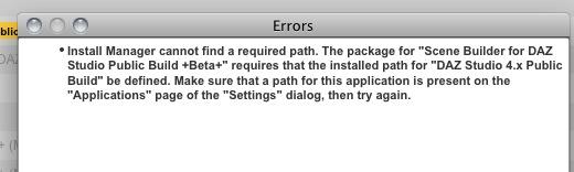

Will studio 4.8 run on mac osx 10.6.8? I am able to download an install the public beta on a machine running 10.10, but the installer doesn't appear to even show up on the 10.6.8 machinein Dim but several of the other componets associated studio4.8 do.
ecxept i get an error.

    You need to click on the little 'gear' icon at the top right of the DIM, select the Applications tab, and enter the path to your DAZ Studio 4.x Public Build. If you don't have the beta installed already, you can't install Scene Builder.
    If you are not seeing the installer at all, it may be that you need to adjust the 'Download Filters' button on the main DIM interface, to include 'Public Build' and 'Software' and also check the box 'Show Hidden'
    Post edited by JimmyC_2009 on
  • fixmypcmikefixmypcmike Posts: 19,742
    That error message means it tried to install a plugin for the Public Build before the Public Build itself.

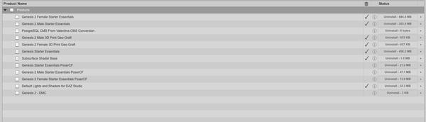

    Thank you all, I'm wondering if I can have this build on two machines, as it is working perfectly fine on my primary machine running macosx 10.10. On the 10.6.8 machine I don't even see the installer being available.

    Here is the content, is this the latest updates for the content?

    In the Download Filters you need to tick "Software".
  • wscottartwscottart Posts: 447
    Thank you very very much The software download was exactly what I had been overlooking. I will make sure that one remains checked.
