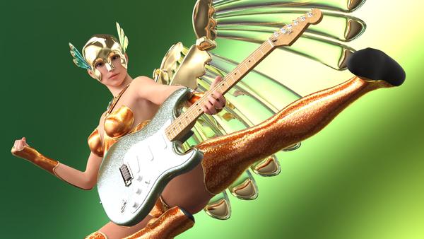

    Herewith an example.
    The original HDRi is pretty much monchrome in this image, as evident in the reflections, and yet produces this green cast at this position,
    I coloured the assets within the image to use the green cast to my advantage, but it would have been a pain if I hadn't had that flexibility.
