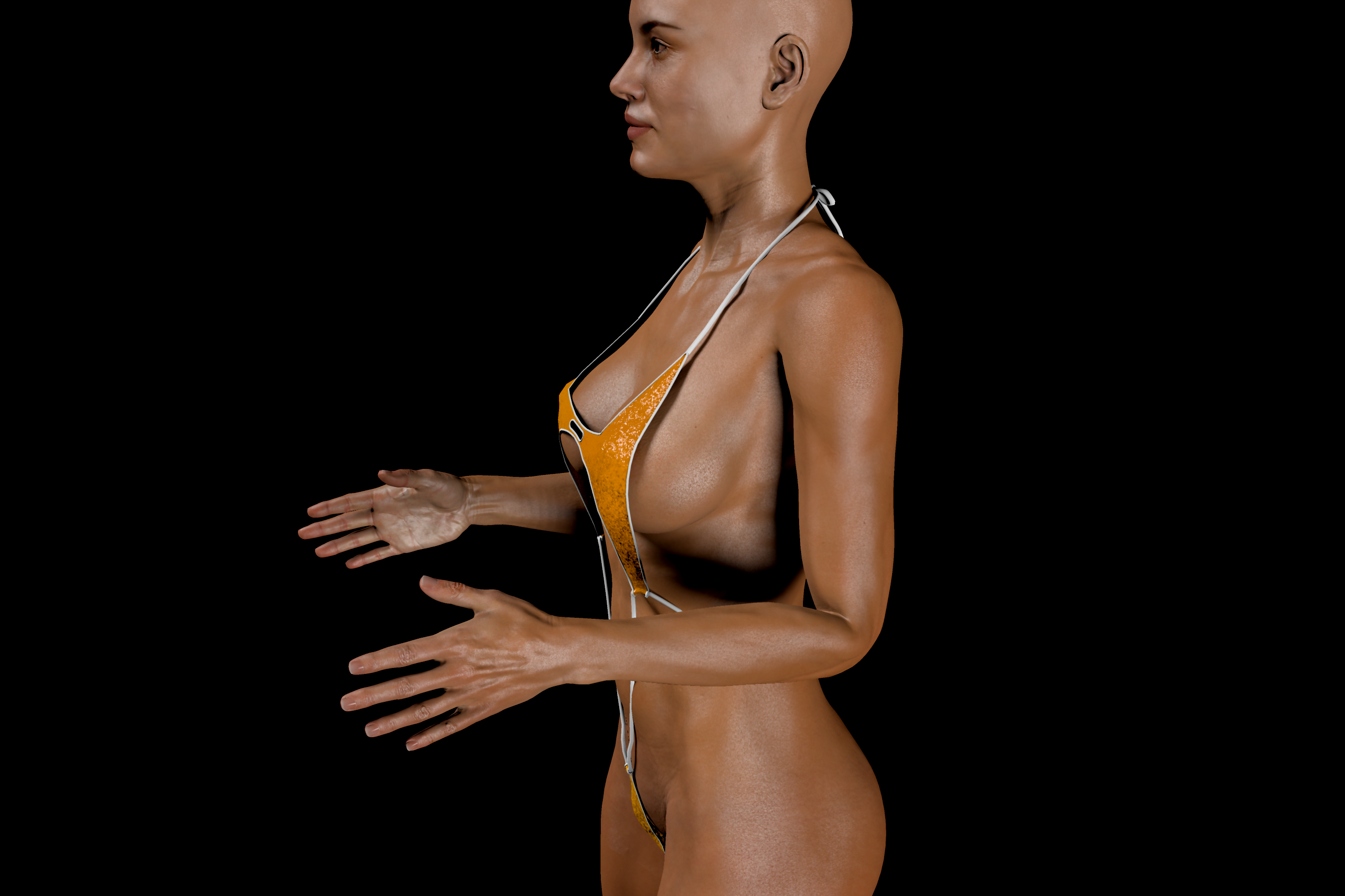

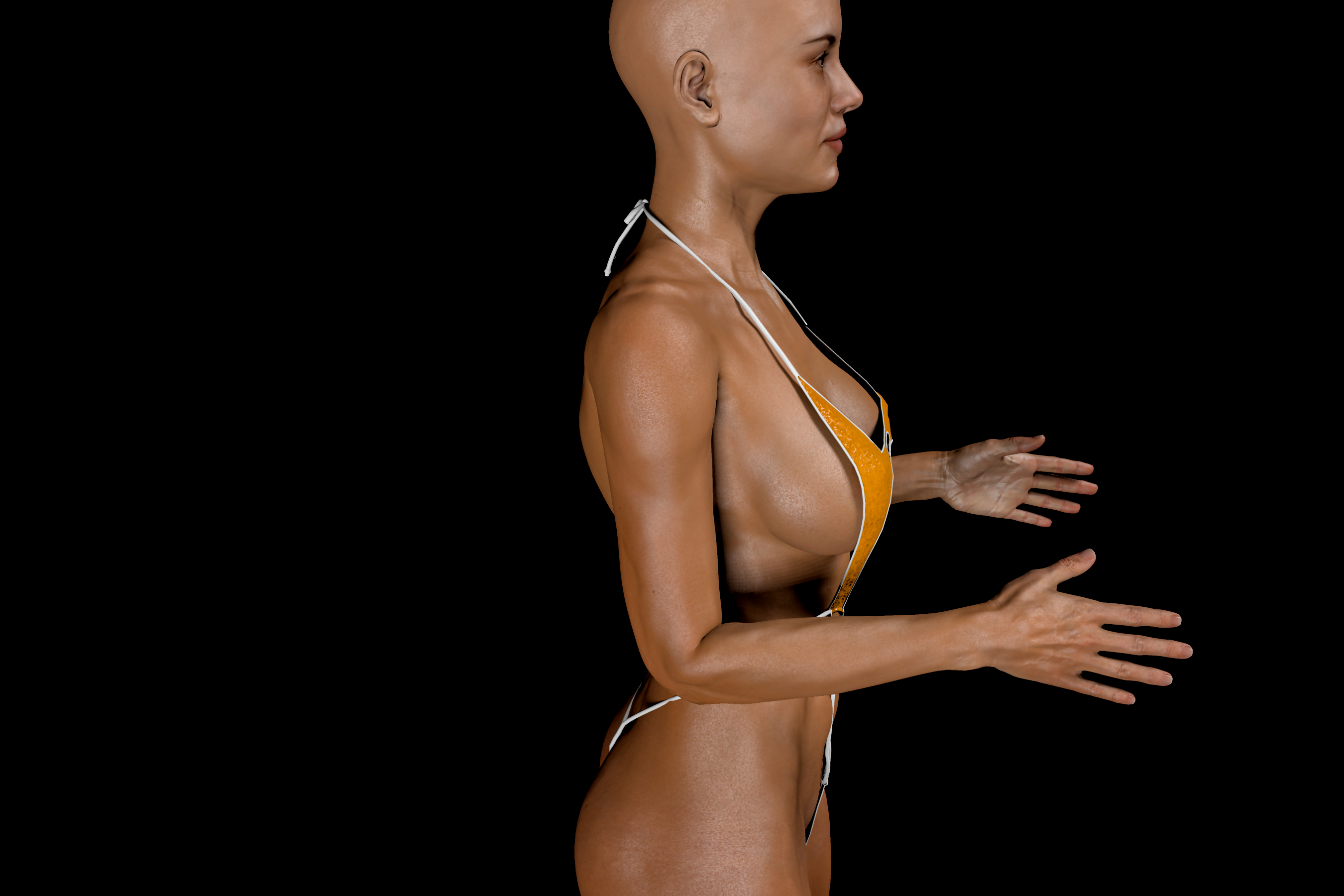

    G3 wearing Aiko 3 3rd party swimsuit.  Swimsuit is an OBJ, not a Daz product.  Swimsuit took about 10 minutes to adjust.  Would be better if I was optimizing for a specific render.  I also smoothed ears and torso, which took about 10 seconds.
    I know that virtually everyone here already knows how to adjust stuff in the modeling room.  I'm just trying to be clear.
    With wonky elbow bend
    From the other side, adjusted elbow bend.  Not perfect, but also took only 10 seconds.
    Loaded and saved in 2 seconds.  For these quality of maps, that is just ridiculous.
    yes 2 seconds is amazing for that quality!
