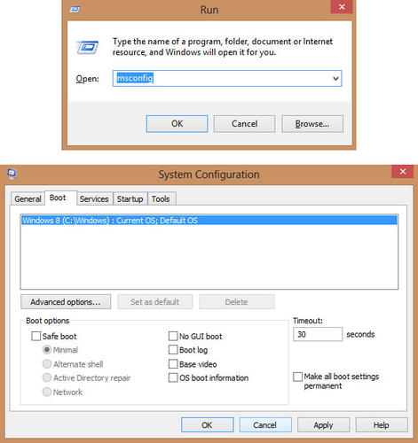

On windows 7 and 8 you can also try this method:
- Type msconfig into the run option (start menu on w7 and windows-key R on w8).
- Click on the boot tab of the System Config window, and ensure that minimal is highlighted then reboot.
- Run the Driver Uninstaller in Safe Mode, then adjust the boot option so you can boot back to regular mode.
- Install Drivers.
