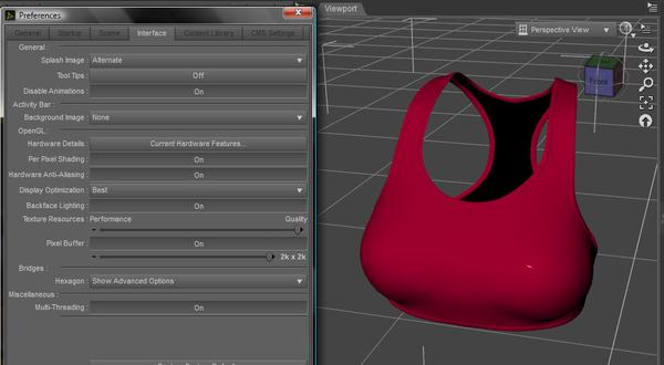

    You can use the viewport to help show "flipped" normals, the attached pic is my OpenGL settings in 4.6 and 4.8 (pic was taken in 4.8), I've been using this for a while to help "fix" flipped normals for my friends, as it makes the normals stand out like sore thumbs in the viewport.
    Will it show them in wireframe shaded, though?
    Yeah, simple 'fix' if it doesn't, flip to solid or texture shaded....
