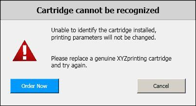

    well my Vista laptop is out apparently
    need to make room in my bedroom with desktop
    on floor for now
    needed to download repetier host as the included software hates my computer too
    was intending to do firmware hack AFTER warranty ran out not now but it does not even recognize Australia as a valid country so cannot register so blah!!!
    and no cannot use THAT either without hacking printer itself
    I found had to do AUSTRALIA shouting BTW
    so need to get this damn software working somehow

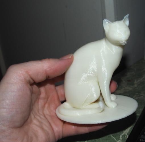

    my first attempt failed miserably and took 12+ hours
    made mistake of adding rafts, it printed solid!!
    was Jaderail but all you see is legs and arms and a big block of honeycombed plastic (yes I broke it open)
    .......... and wasted half my ABS filament
    second go took two hours and was a success, went much smaller and used lesser settings, a kittycat of course
    will try smaller and work my way up maybe doing parts and assembling in future.
    after all cannot have bits suspended in mid air printing so joining bits best solution.

    I did robotica head as my first attempt, I was going to do the full doll but decided it would take to much time, but at least you got your first one done, I was very impressed and excited when my first one was done, makes you want to do more.
  • thd777thd777 Posts: 946
    Kitty looks neat. For the Jaderail figure, I would recommend to add bridges to connect the sword sheaths to the legs (for example using a horizontal cylinder primitive in your modeling program). You can then cut those off once it is printed. That is a pretty common way to allow printing of models that have parts that otherwise would have to be printed in mid-air. Another option that sometimes works well is to print the model upside down. Depends of course on the geometry.

  • ncampncamp Posts: 345
    Wendy,
    I keep my printer in the Garage. I don't want to be around ABS fumes for too long. Some stories say they are bad for you and others say they are not. I would recommend that you put it in a well ventilated area if you can.
    All of my prints are off of an SD card, so I don't have to keep the computer connected. If your printer supports an SD or USB card, then you would not need a dedicated computer.
    Also, you don't need to print the objects to be solid. A 10% to 20% infill will be just as strong (maybe stronger).

    It is indeed honeycombed, I am uploading a long boring timelapse video of the job.
    I need to hack the firmware to use the SD card but will wait till out of warranty, have looked into how, it will mean cheaper and more varied filament too, this one uses cartridges with a chip that records how much to stop people refilling.

    Thanks Wendy, for allowing us to share the trials and triumphs of using your printer!
    The cat looks great - I'd be very pleased if I got such a result! (I'd be very pleased just to have the printer!)
    In traditional sculpting, to make multiple copies of a piece, the artist makes mould sections surrounding the object. Then another medium (plaster, clay, wax, etc.) is poured into the mould to make the copies - out of the chosen medium, obviously.
    It always seemed to me that, with a bit of ingenious modelling beforehand, a 3d printer could be used to make the mould sections only. (Think of two halves of an Easter egg, for example). In normal mould-making, short studs are built in along the edges to position the pieces together correctly.
    Such a mould generally wouldn't have thin swords and other thin parts to bridge - these would be in two halves as little trenches in the mould. Traditional sculpting techniques could be used for the finished work. Cold-cast bronze, for example, is only Perspex, or something similar, mixed with metal powder.
    BTW The simple shape of your cat lends itself to making a one-piece latex mould out of it and making multiple plaster copied. I don't think there are any undercuts.
    OOPS, after posting I see that the legs would make one-piece difficult.

    Looks great! And that is a small one, how big can you go?
    I looked up the material safety dafa sheet for Acrylonitrile Butadiene Styrene (ABS). If that is the material that is used, you don't want to sleep in the fumes and do the printing in a ventilated area. In solid form it seems pretty harmless, but the fumes can cause problems for your eyes, respiratory tract and also skin if the fumes condensate on it. Though normally that information should have been provided with the equipment.

    Yes the supports were actually what caused the failure of my first attempt, the cat I studied the model carefully for floating parts facing downward and forgot the whiskers which I would have removed.
    As it is one actually printed!!!
    Was unexpected, it must have been an upturned one.
    Am very happy with my cat actually but learnt a few things in the process.
    Not expecting the impossible but can see up pointing swords etc are entirely possible even fine ones as the cats ears printed too.
    Is matter of carefully posing for slicing so nothing undercuts anything or is started in mid air.

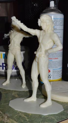

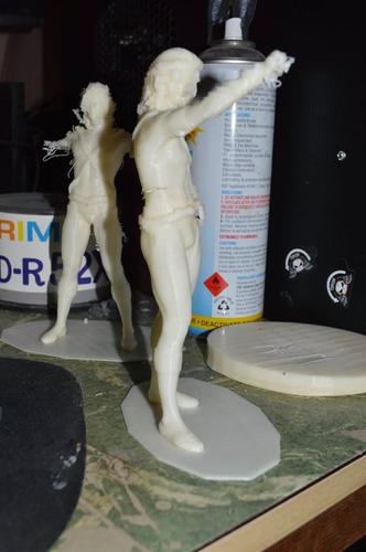

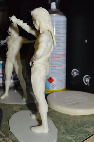

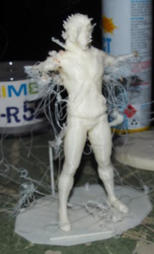

    Jaderail proving a bit difficult
    second go better than first :lol:
    1212 x 2000 - 387K
    638 x 960 - 56K
    638 x 960 - 60K
    638 x 960 - 66K
    531 x 960 - 55K

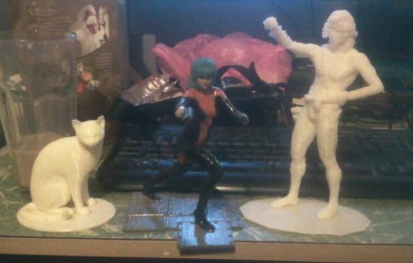

    Mine a very loght DAZ V6 quite solid (sandstone) Jaderail is hollow AFAIK used 0% the cat is honeycomb filled
    704 x 448 - 34K

    They look all very nice, Wendy.
  • Hermit CrabHermit Crab Posts: 885
    These look great Wendy. It always seemed a bit suspicious to me that few figurines are ever featured in sites advertising affordable printers.
    But you've shown what can be done and I'm sure each new work will teach a bit more about how best to go about this.
    Hoping to see more!
    PS - I wonder if it might be worth investing in a Dremel type of tool to use for clean-up?

    update
    do not buy an XYZ printer with its software that limits it to their microchipped cartidges
    I bough $200 of genuine cartridges and am right pissed of right now
    Dear Customer,
    Since your region is for AU, and our region is for
    USA, please kindly contact your retailer.
    Thank you.
    Best Regards,
    Customer Care (Sheena)
    XYZprinting Inc.
    www.xyzprinting.com
    of course there is no Australian Customer service
    it is a software issue
    not the retailers fault
    I probably am going to have to hack the firmware on this thing to use it if I cannot get it sorted under warranty because their faulty cartridge chip DRM designed to make you buy their refills is penalizing genuine customers which is very bad.
