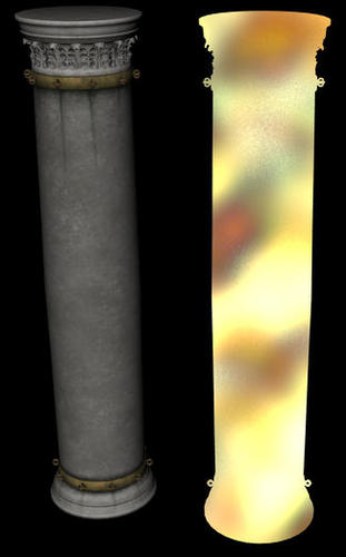

  • meipemeipe Posts: 108
    I just remembered this fog shader in Renderman docu:
    https://renderman.pixar.com/resources/RPS_17/atmosphereAndInteriorShaders.html
    I though it may interest you.

  • Mustakettu85Mustakettu85 Posts: 2,933
    meipe said:
    I just wondered, because in Shader Mixer's 'Volume repository' (on DS 4.7), I see four bricks: Depth Cue, Ray Marcher, Simple Fog and Smoke. In Shader Builder's sample catalog, there are two volume shaders: RI:DepthCue_Simple and RI_Fog_Simple, with simple macros that can be edited. But I don't know If they match the first and third of Shader Mixer's bricks...
    Stuff along the line of those simple depth cue and "fog" shaders is as far as I can go writing "volumes" =) These aren't true ray marching stuff = they will not respond to lights. And thank you for the PRMan link - I believe I have experimented with making another freely available cousin of this shader work in DS (noisysmoke.sl), but somewhere I keep doing something wrong...
