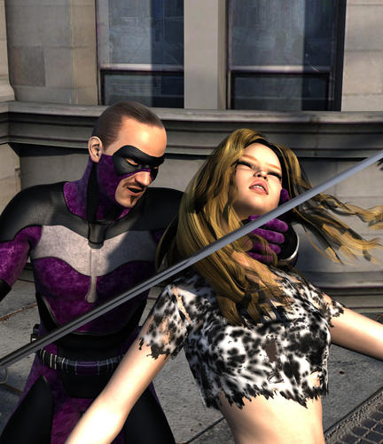

    Which skin are you using and can you post an image showing the problem.
    What scorpio said...at this point being able to see what's going on is going to be helpful.
  • Steven-VSteven-V Posts: 727
    The character model I'm using that is going to "hot" in terms of exposure is FW Cassie for Teen Josie 6. I've attached an example. This is a battle scene in Urban Sprawl 2. As you can see, the rest of the scene seems to be in reasonable lighting, including the skin of the villain who has grabbed the main character. But the girl's skin is clearly over-exposed (by a lot).
    I am guessing there is some setting that will fix this, but so far playing around with it has not given me a good render of this scene. Lowering the lighting makes her look better but everything ELSE look too dark.

  • DestinysGardenDestinysGarden Posts: 2,553
    The Cassie character I just loaded up loads with DAZ Default shader applied. Can you try that one and see if it helps? Also, the specular strength is set to 100% by default and that can certainly cause the blown out highlights that you are seeing. Do you have any of your lights set to specular only? if you have a spec only light at high intensity, it will also create those highlights.

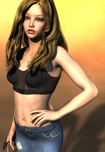

    I think if you apply the regular non-SSS skin you get the DAZ default with Cassie, and I think that is what comes in with the Cassie full figure. I did not use the figure... I applied the Cassie head shape to the Izzy body because I thought Izzy looked a little better for a superhero (she is a little more muscular). I applied the Cassie SSS skin option, which I just tested and it comes in with the AOA shaders. So I think that is why I am getting this happening.
    Here is a little test shot with the lighting exactly the same (I think it was AOA Distant 100%, AOA Ambient 75%, but I could be slightly off). The only thing I did was swap out the AOA shaders on the skin for UberSurface. Notice the difference. I changed nothing else. (First one is AOA shaders, second is UberSurface).
    So clearly, some combo of my settings and the shader presets is the culprit.
    I guess I can fix this by applying the Cassie non-SSS shaders and that will probably solve most of the issue.

    Yeah, the full figure loads with DZ default. FWArt has a folder for base Mats which uses DAZ defaults, and the SSS folder which is using AoAs shader. If you do apply the UberSurface shader to the skin, (which is definitely what I would do with two figures in close proximity in strong light) you can then copy the parameters from the male figure, since he is already looking like you want him to in the light you are using.

  • scorpioscorpio Posts: 8,533
    You could try turning down the lights a bit more, in the image you posted even the male has a bit of blow out, also perhaps angle the distant light slightly away from the girl.
