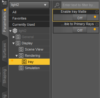

    Make sure Iray is not rendering in the Viewport before executing script or Iray won't notice the fix.
    After executing the script check your Parameters tab, you'll find two new properties "Enable Iray Matte" and "Iray Visible to Primary Rays" under path "Display/Rendering/Iray".
    The property "Iray Visible to Primary Rays" controls light geometry visibility On = light geometry visible, Off = light geometry not visible.
    HTH
