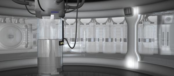

  • konkon Posts: 389
    how is this?
    1220 x 534 - 306K
    The vertical lines in the tank in the front?
    They could be due to the shading rate...so what are your render settings?
    Or they could be caused by the geometry of the 'water' intersecting the geometry of the tank...if that's the case, try scaling down the 'water'...not much, try 99.9% or 99.8%.

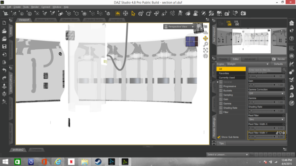

  • konkon Posts: 389
    What do you mean scale down?
  • konkon Posts: 389
    these settings?
    1366 x 768 - 773K
    Yep...need the shading rate and the raytrace depth. If you hit All you should be able to get both items in the shot, if you scroll down past the size settings.
  • konkon Posts: 389
    I see shade rate but not raytrace depth.
    1366 x 768 - 220K
    It should be 4 up from Gain...Max Ray Trace Depth.
  • konkon Posts: 389
    ok its at a 2.
    ok its at a 2.
    Up it to at least 4...possibly 6.
    It will slow the render down somewhat, but it will give much better glass, especially at the transition between the glass and the liquid.

    Which set is it?
    You should probably drop the shading rate to about .5, too...

    try converting the model to SubD and rendering. Do the lines go away? If they do, is that usable? If bits go AWOL, try changing the Edge Interpolation setting under Mesh Resolution in the Parameters pane.

    Select the figure or prop. Edit>Figure(or prop)>Geometry>Convert to SubD. try rendering.
  • konkon Posts: 389
    Ok ill try that. What is sub d?
  • konkon Posts: 389
    Seems to be working but the render is taking forever.
    Yep...all the above suggestions will increase the quality of the render...and geometry, but at a cost of increased render time.
  • konkon Posts: 389
    Nope i was wrong didnt work. Thanks anyway everyone.
