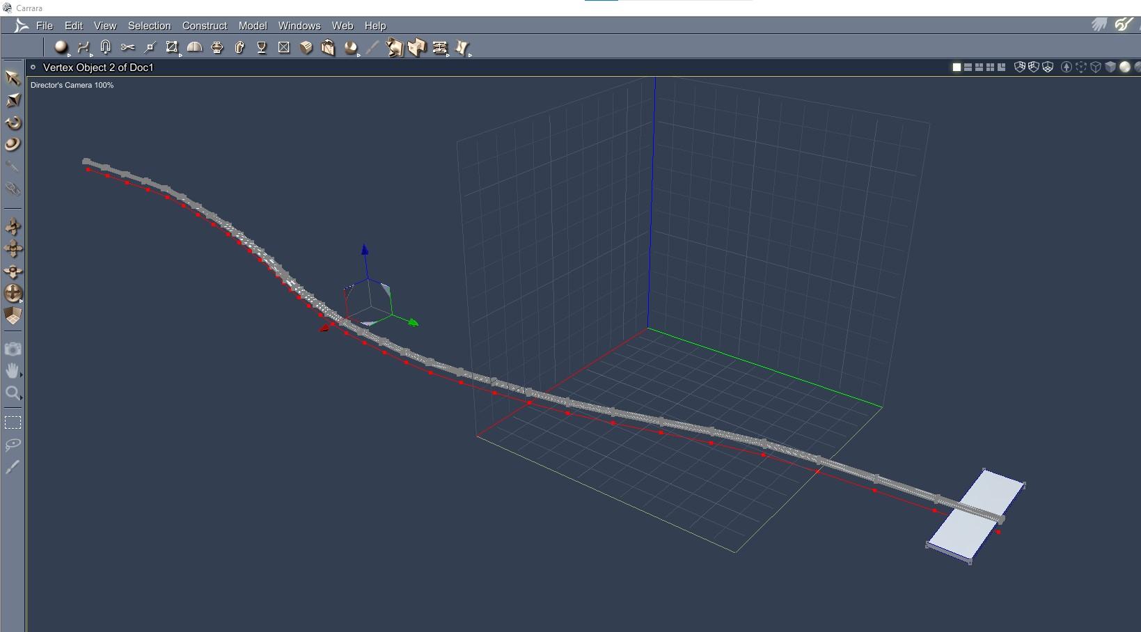

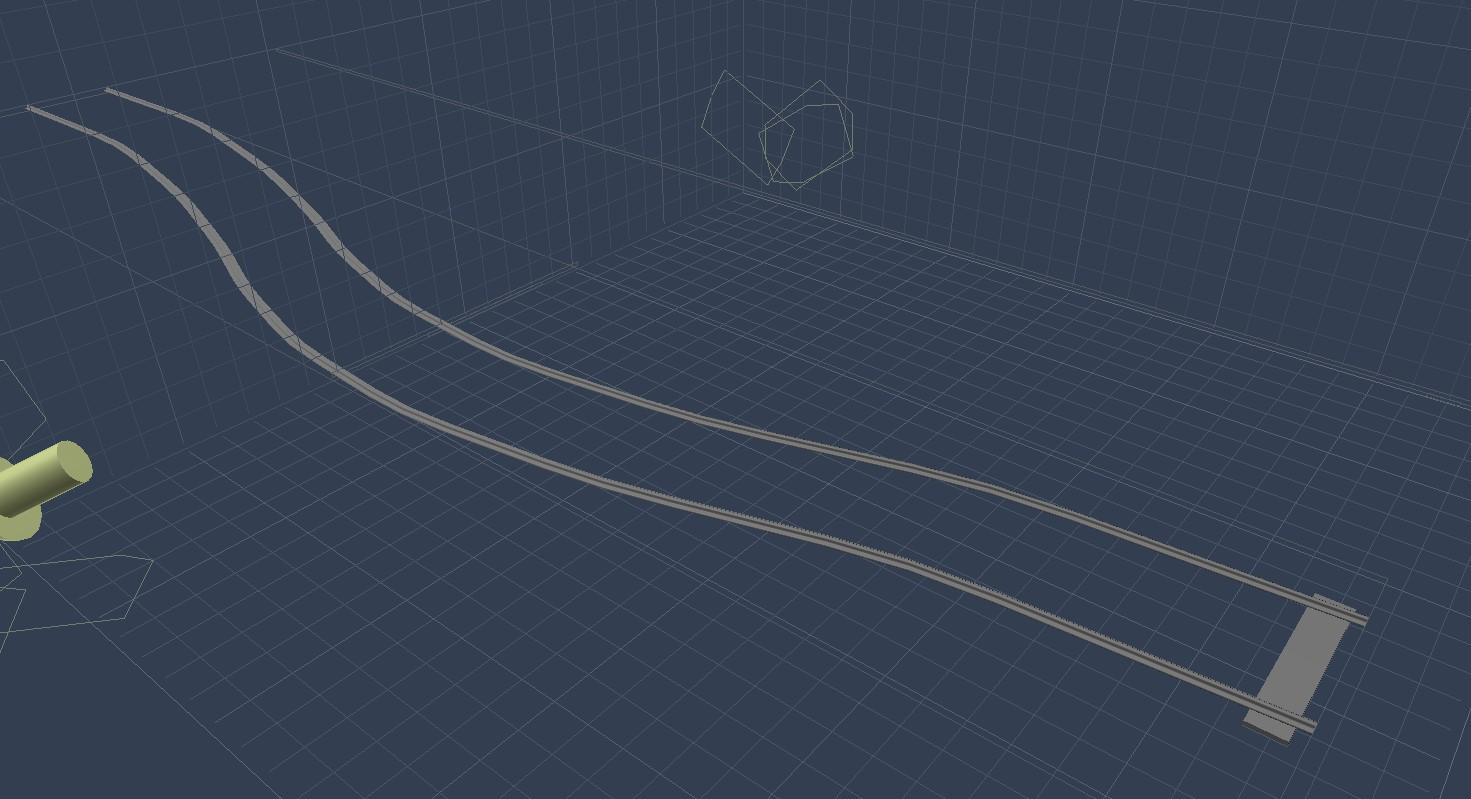

Thought I was putting together a quick train tracks and it turned into a modeling question.  In the vertex modeler, is it possible to take a submesh and duplicate it along a path?  Although I am trying to do it on a curving train tracks, the same issue could arise for a necklace or charm bracelet and many other situations.  I know for my present project I could just duplicate the planks along a straight path, rig the straight path and then use the posing tools to create my curved train tracks, but I am curious about the potential modeling feature.  Could the feature be in one of the DCG plugins?  Am I confusing Carrara with Hexagon or another modeler?  Can duplicating at regular intervals along a curving path be done in Carrara?
In the screenshots, I have the two side rails in one picture, and I present the middle of the path in the other.  I'd like to duplicate the rectangular plank along the central path at regular intervals so that it curves with the outer rails.  I have extracted the central curve from the middle rail.

  • StezzaStezza Posts: 9,291
    only way I can think of is in the assembly room and using Sparrowhawkes duplicate on surprise

    Hi one of the plugins made available to us has a feature for making chains from links . Could be what you need? NOt on my machine at the moment but i stumbled on it t’other day. Will have a look later.
    sparrowhawkes duplicate on plugin works a charm for this - couldn't get Replica to do it unfortunately - lack of practice on my part
    car file attached as a zip.
    I changed the hotpoint of the sleeper (vertex object 1) so they would align ion the right place with the rail (vertex object)
