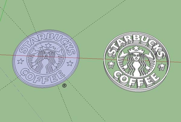

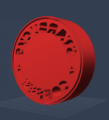

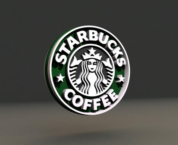

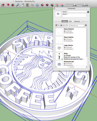

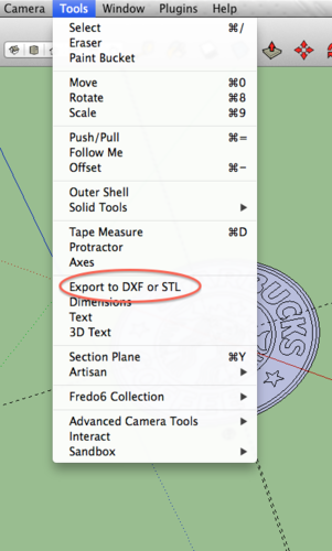

    OK, will try to illustrate the process in converting models from SketchUp to Carrara, in my personal experience this has been very useful, as Carrara brings a very detailed and well done renders, since I save time modelling in SU as you previously said.
    Ok let's say that you need to model a logo, in this case the Starbucks logo:
    1.- The best thing to start is having the logo in vector art, illustrator is one of the best things to manipulate vector arts, so in Ai, you need to convert that file to .dxf that makes that SketchUp can recognise the lines and you may model them.
    2.- In SketchUp you need to convert the model parts in components, every part of the model that needs a different color must have their own component. Carrara recognises the name of the components the which is cool when you are assigning different materials in the shader room to a large component file.
    3.- As I've said before you need a plugin called "Export to DXF/STL", depending your SU version download the version according to that, you can find some here:
    http://sketchupplugins.com/plugins/convert-sketchup-skp-files-to-dxf-or-stl/
    For some reason this plugin runs under the Tools tab, and not in the Export file option.
    4.- Once you have named all the components in your model, select them all and choose the option above described, under the tab "tools" chose the Export to DXF /STL option, a window will display asking the options, select the following:
    Export Units= Meters
    Export to DXF=Triangular Mesh
    Save the file as you want be saved
    5.- Open Carrara and chose the Import option, in my case the most of the times I do use a wizard scene, as it has previous ambients and lightnings.
    6.- When you open the file in Carrara you will see the model with the components, ready to be shaded.
    Here you will see a group of images trying to illustrate the process, hope it helps.
    Cheers!
    Otto

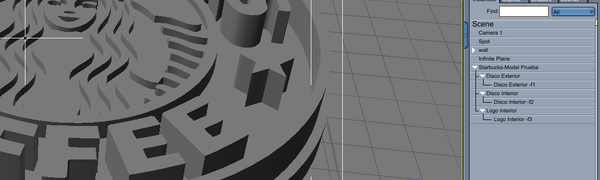

  • DiomedeDiomede Posts: 15,464
    Thanks so much. Clarification. Are you importing the dxf shape as a vertex model? Or, are you importing the illustrator file to the spline modeler?
  • otodomusotodomus Posts: 332
    edited April 2015
    Hello! The DXF file is imported directly to the assemble room, where you can shade every component, sometimes a mesh made through this process can make a mess or simply can't be textured in the right way, in that case what I do is convert that component in to "other modeller" as a vertex model, there you can manipulate the UV mapping or edit the model.
    The illustrator file is to make the drawing enable to be modelled in SketchUp, in Ai what I do is to convert the vector file in .DXF file, SketchUp opens that and you can extrude the parts.
    I have never tried to import a .DXF file directly to the spline modeller I wonder if that is possible...

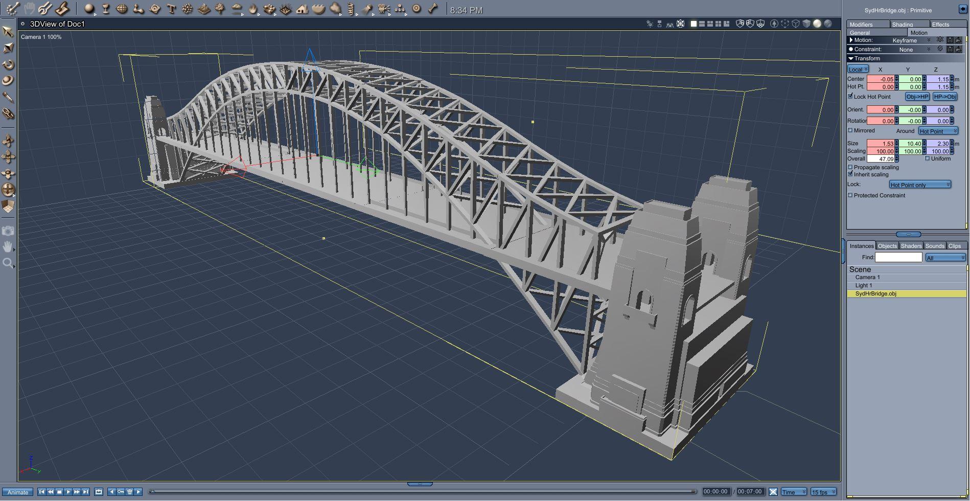

    Thingiverse has a .STL version here: https://www.thingiverse.com/thing:43455.
    You can open .STL files in Blender and resave them as an OBJ usable in Carrara. I tried it out and it looks like it arrives in Carrara in pretty usable condition. It's just half of it, so I had to duplicate and rotate to get the whole thing.
