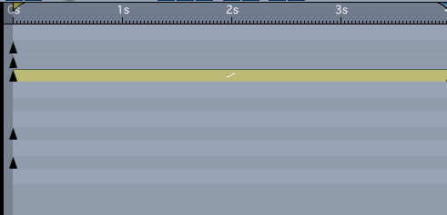

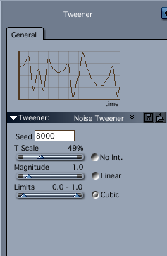

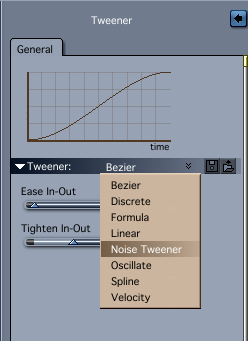

    You're on the right track with the replicated leaves I think, because if you animate the orientation, that will be carried through to the replicants. If you add more of the leaves to the replicator and change the orientation of each added leaf a bit differently than the first, then it will add a bit of randomness to the movement. If you need the movement to be sporadic, then use the tweener.
    To use the tweener, set the position of the leaf at the beginning of the animation, then move to the end of the animation and change the position. Click in the space between the keyframes and you will be able to edit the tweener. Switch it to noise by using the pulldown menu. I think you will want to change the Noise tweener to use the Cubic method. The T-scale means Time Scale. If you need more movement, slide the slider to the left. Less movement, slide it to the right.
