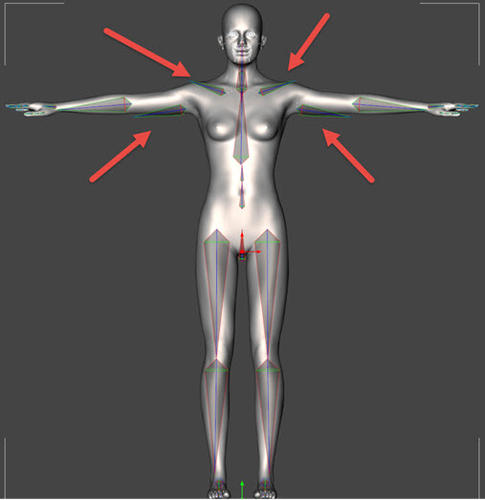

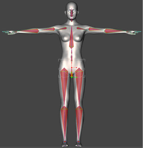

    Well, it looks like I'm still having problems.
    I adjust my rig accordingly, and when I reload my character, the bones are in the incorrect position. I can correct this by doing auto-adjust to shape, but I cannot afford this for the project I'm doing.
    Does anyone have a solution?

  • Richard HaseltineRichard Haseltine Posts: 111,777
    Did you memorise the rigging and save the figure?
  • GuruvarGuruvar Posts: 344
    Hello Richard,
    Thank you. I was making the mistake of choosing 'Save Modified Assets'. It turns out that you have to overwrite the saved character completely in order to sustain the joint positions.
    Much appreciated!
