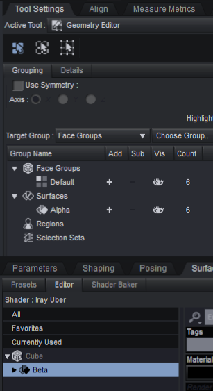

    For the first part of your question, I suspect the issue is name vs label.
    var oMaterial = Scene.getPrimarySelection().getObject().getCurrentShape().getMaterial (0);oMaterial.setName ('Alpha');oMaterial.setLabel ('Beta');
    This will result in
    However, the label is not a saved property. If you save and reload this node, it will load with both name and label set to Alpha.
    It is not clear what you mean by the texture being lost after saving.
    307 x 563 - 51K
  • Problem solved,Thank your very much!
