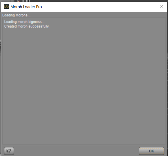

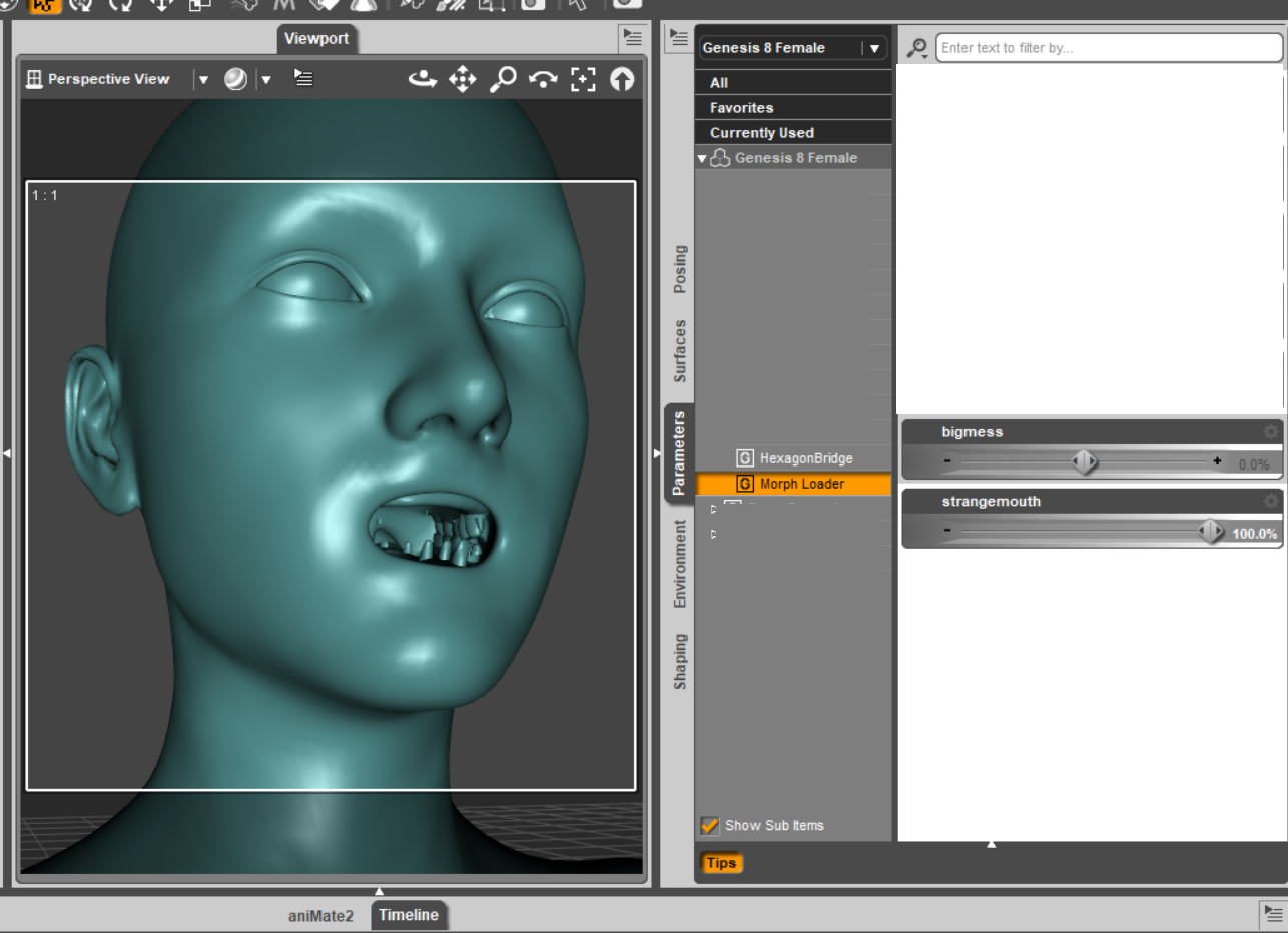

    edited January 2022
    galien said:
    The problem I had when I tried 3DCoat is that I couldn't find any way to stop it from changing the topology of models exported from Daz Studio.  This meant that it was useless for creating morphs for Daz Studio.
    Be it for morphing or making new uvs at first I thought the same. BUT then I discovered yes we can! Rather than the expected route, under the Textures Tab, export UVs. That produces an .obj file which can be used for making morphs via Morph Loader in D/S, or for bringing in a new uvset in D/S under the Edit, load new uv set options.
    I am using a slightly older edition of 3DCoat so the interface may be a bit different from their latest edition however the concept is likely the same.
    n.b. Figure at Base resolution, "0" subdivisions, NO eyelashes [G8 figures] or any other grafts, I also apply a basic 3D shader, no images before exporting figures, and use the collapse uvs option on export, and NO groups ;-)

  • galiengalien Posts: 150
    edited January 2022
    Catherine3678ab said:
    That's interesting.  I don't remember trying that (though I'm guessing that it only works in the tweak mode).
    I stopped using 3DCoat a while ago as I found other software that worked better for me.  Like you, I bought the lost cost amateur license, which is no longer available.  Nowadays 3DCoat costs 379 euro, and I wonder whether a combination of ZBrushCore + Substance Painter (via Steam) + RizomUV would be a better option for a little extra cost.  Blender is also far more useable now as well.
    Post edited by galien on
  • No, the ability to export out the "uv obj" on the Textures Tab, AFAIK, works from any 'room' - or at least from more than the one.
