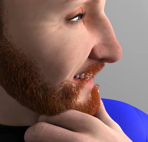

Supposedly this is possible, but my results have been... not good.
I'm using a bunch of morphs (aging and expression stuff).
Some searching uncovers mention of Transfer Utility, but I can't make any sense out of how I'm supposed to use it.
Help?
To be clear, Unshaven beard here: http://www.daz3d.com/unshaven-beard-for-genesis
1125 x 1080 - 2M

    Aaaand changing the 'auto follow' is still not doing anything.
    At last count, morphs that seem to be causing problems:
    None of the expressions (Happy, Scream, etc. The beard will move a little to follow the overall jaw movement, but the changes to the face are ignored)
    Stuff that shapes the face seem to have a 50/50 chance of being recognized. Morphing the lips and reloading the beard seems to work. Morphing the cheeks, not so much.
    All of this is after making sure Auto-follow is on.
    So I'm still stumped and I'm confused why other folks seem to be having better luck. :/
    Edit:
    For example, make a G2M, set Happy expression to 'auto-follow,' make him Happy 1.0, then apply Unshaven beard (Genesis/full-body), look at his upper lip.
    (This is important to me and will probably spell the difference between whether I stick to Genesis or not, because Unshaven is just that versatile for, like, ALL MEN)
