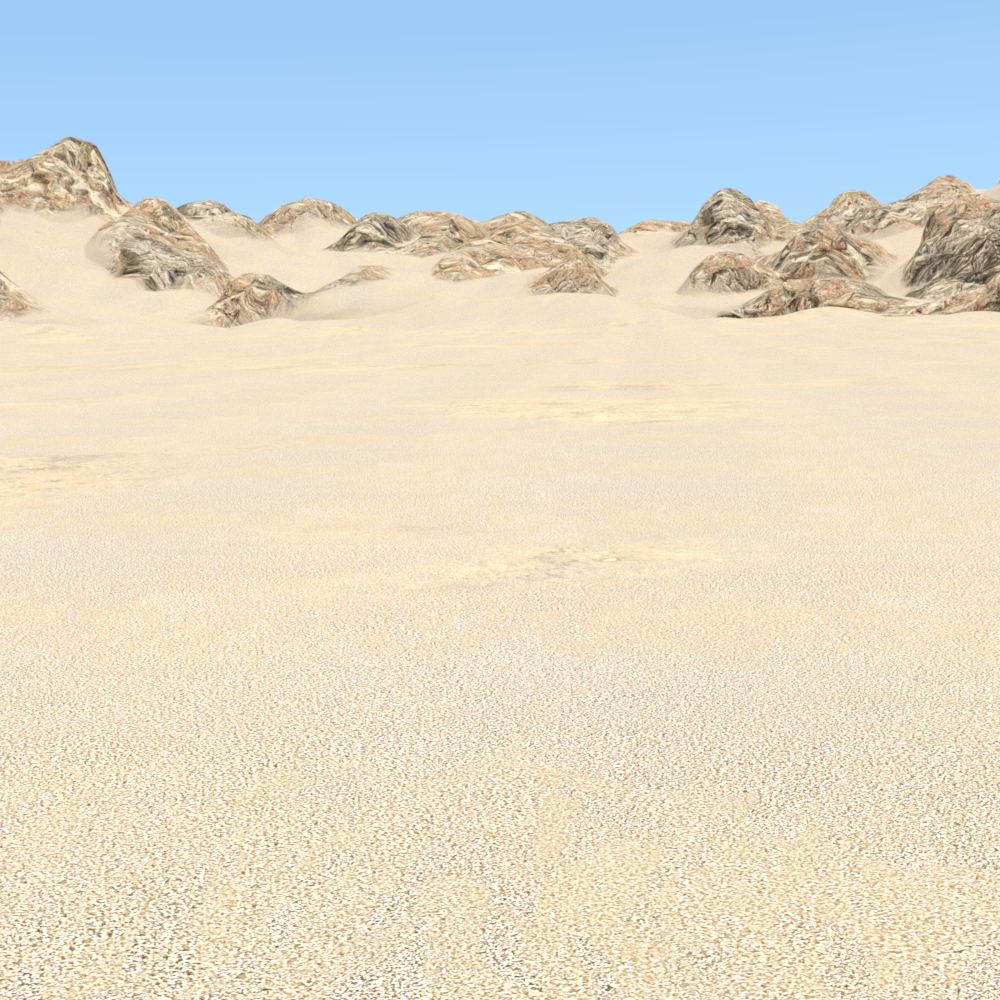

    Searching the store for the product, turns out I have that. So I loaded the "Alternate Version", loaded the cameras, rendered through the Main Atmosphere Camera, used the supplied render settings DD Sun-Sky 02. {didn't matter whether draw ground was on or off}.
