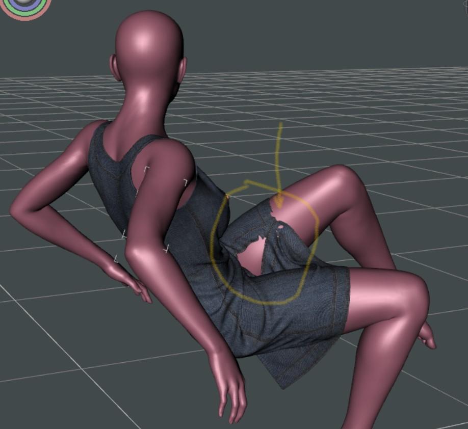

Here's an example of a quirk with dForce that is quite bothersome.
This morning I bought this dress because it has buttons which can be opened. Well, actually that's not quite correct: I was a little disappointed to find that there are no parameter sliders to open the dress; instead there are four different load options with the dress in four different states of "openness". However, I digress.
The problem I have which is ongoing with dForce is that the mesh gets pulled towards other mesh objects quite unpredictably. Quite often these are fingers or props which are visible to the simulation even though they are not in contact with the cloth mesh. Yes, we can turn off visibility but it looks to me like a bug.
This dress shows the problem in a different way. After loading the version with a partial skirt open and ran the simulation, I find that one flap of the skirt is attracted to the other so the drape does not work as intended. I just wonder if anyone has advice abut how to stop dForce from being dragged towards unattached mesh?

    I take it you mean the Button Links in the scene tab? Even so, I'm not sure how that will help. The thing is that I have other dresses which open and they have a parameter slider which pulls the cloth aside (a morph, I assume). This dress comes with four different load states as you can see in the screen shot. So If I have the character wearing the dress in a series of scenes (which is how I work with DAZ Studio) then I have to delete and load another dress option if I want to show an unbuttoned drape. I do make my own morphs for clothing quite often but my skills (and software options) are limited.
    Nevertheless, this is something of a distraction from the original question about why dForce has this odd habit of sticking to mesh that it is not initially touching. To be clear, I wasn't saying that the dress is being pulled towards the buttons. In the image attached to my OP the mesh to which the dress is stuck is actually the left thigh of G8F. A real-life drape would have that flap of the dress falling but that corner of material just sticks like glue to the thigh.

    Thanks - that does the trick if I want to remove the influence of the buttons and then drape which turns out to have better results than I expected.
