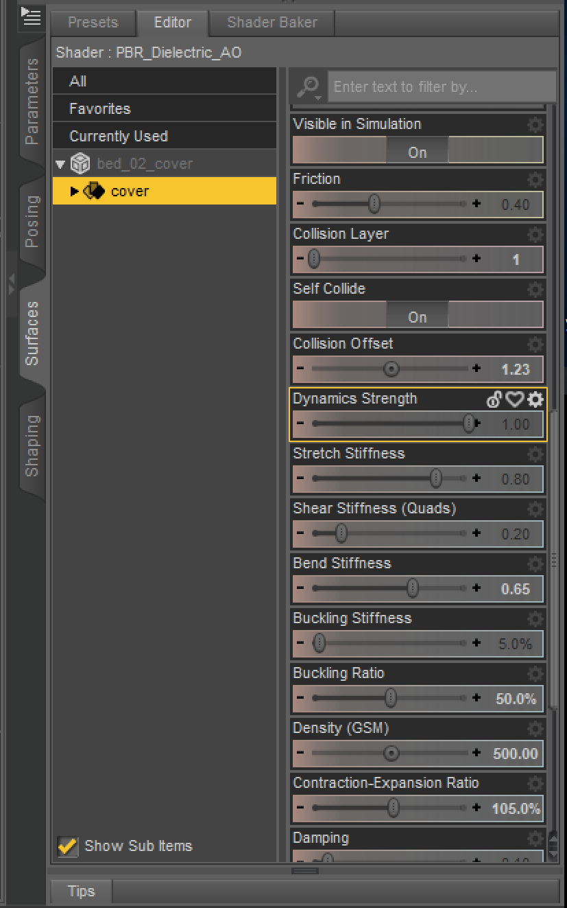

    My attempt didn't come out so well.
    Here is the dforce settings for Euro Duvet, anything not shown is default.
    2000 x 2000 - 826K
    827 x 1323 - 73K

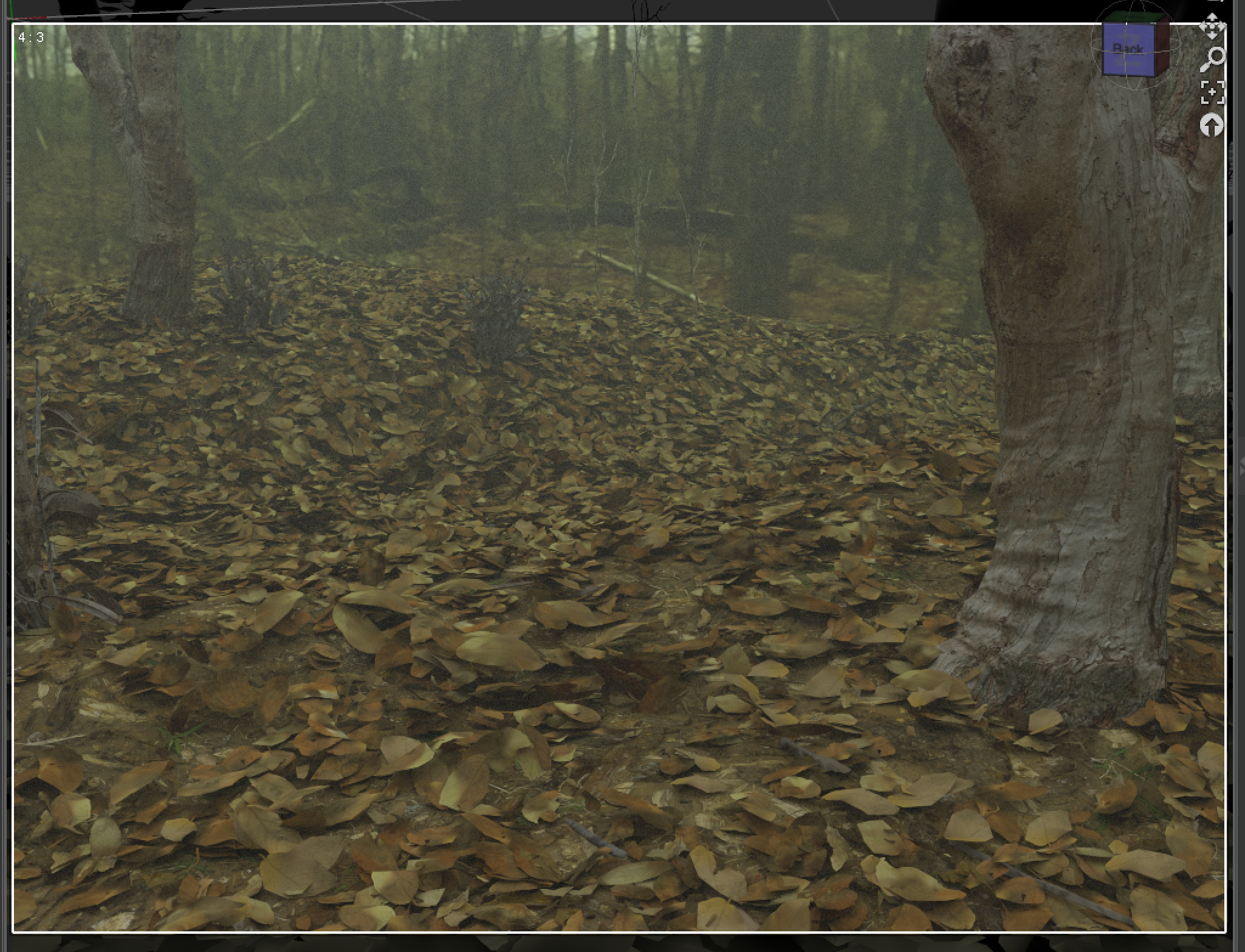

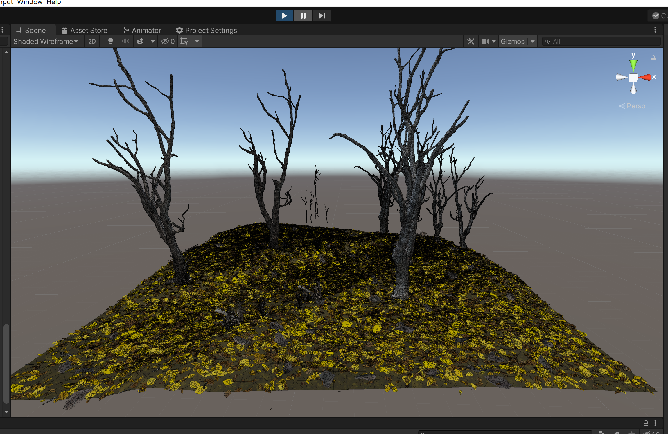

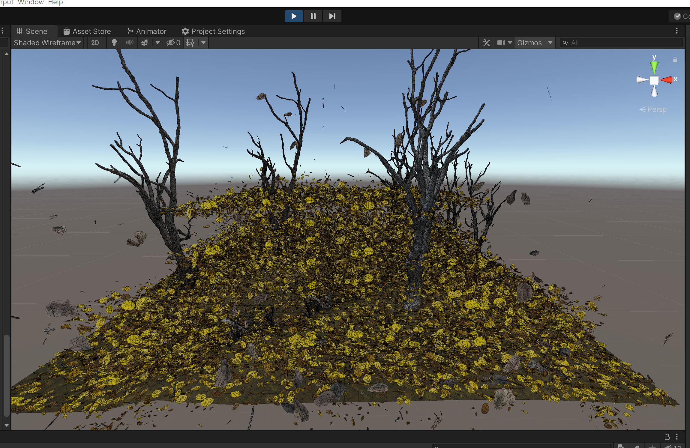

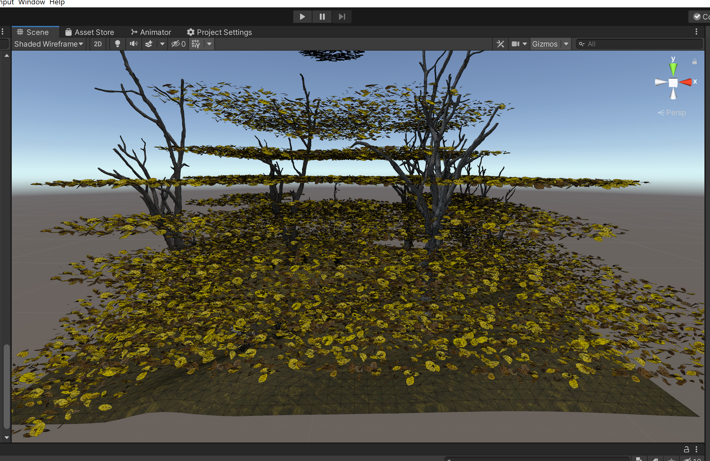

    So one thing I do for advanced physics is to use Unity3d. I wrote my own OBJ exporter that has options for sending it the OBJ through blender command line for mesh cleanup which I don't mind sharing the code. There is other free ones too. And Unity is free for indie. Sure it's intended for making games, but one can use it for so much more. With C# support it's easy to knock out code in minutes.
    Here is an example I did a couple of nights ago for littering a ground segment with thousands of leaves and sticks. Took about 4 or so hours to set it up, write the code and export final results.
