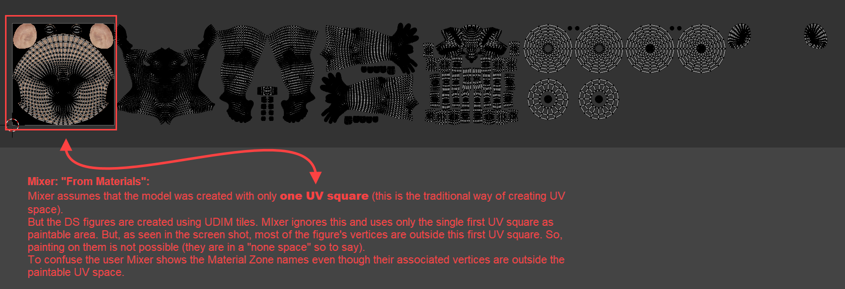

My take on it - I assume your issue is that you did not switch to UDIMs (see attached picture 6-b.png).
Edit:
I read the Mixer webpage again and am not sure whether it should also work with "From Material" instead of only "From UDIMs". What I noticed is, that I can paint on all Materials when I am in 2D view but as you said it does not work in 3D view. When creating the Layer set from UDIMs it works in 3D and 2D view.

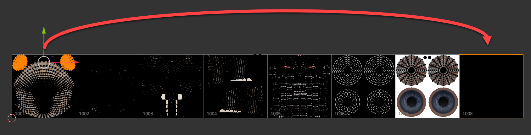

Now I am trying to export with the geografted parts (Cthuloid tentacles and God of the Sea lower body). If you look closely at the face, you can see there are three overlapping UV maps.
I *think* the UDIM wrapping is set up that G8M has a zone labelled 1001, and so does the Cthuloid tentacles and the God of the Sea. So all three material zones are called 1001 and overlapping as one. When I set it to Material instead of UDIM in Quixel, the zones are there and separated for each part.
I saw a Blender tutorial for renaming material zones, so I will hunt that down and try renaming them and post back. Looks like quite a few people have viewed this thread.
I am no expert regarding geografts but I think your are right, that the uv of the tentacle is assinged to UDIM tile 1001. So, face and tentacle are on the same tile. That of coure does not work well. You might be able to solve this with Blender by creating a new tile and moving the tentacle geometry to that one?

Regarding the Material Zones vs. UV space. They are different things.
Simplification:
So, if you create a new UDIM tile and move the vertices there, their material information does not change but their position in the UV space does.
So, I assume renaming the material zones in Blender might not solve your issue, but altering the UV layout might do.
And one more. I think I understood how Mixer interprets "From Material" vs. "From UDIMS".
These are generally two different ways to define the total UV space:
