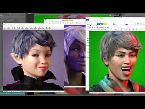

like the figurizer tool used in this video:
yes that's it, by selecting specific elements. The project is not limited to the single sale of NFTs, they will be integrated into a metaverse and above all 90% of the funds raised will be used to provide returns to NFT holders. I want to generate them via DAZ because the rendering is incredibly realistic.
