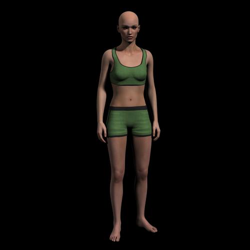

So I've been trying for, well, basically two years to make a shader that mimics the DS Default Shader but exposes the hidden parameters as well as adds an Ambient Occlusion function. I'm getting close. Finally! There are still a few caveats and a few gotchas but it's nearing the point where it is showable.
Caveat 1: Each Lighting model of the default shader gets its own "Plus" Shader. This is necessary to expose additional options on a per "lighting mode" basis.
Caveat 2: This shader adds AO. Period. It's not something you can toggle. It is on or it is off. I have an idea of how to get around this but I'm not "there" yet.
Caveat 3: CTRL+loading of the shader will allow you to respect maps. However, it still wipes out strength settings, etc. No idea how to fix that yet, be happy I got maps working. LOL.
Here's the first sample. DAZ Default Shader, Lighting Mode Skin on the left. DDSPlusAOSkin shader on the right.
Thoughts? Anyone interested? Anyone want to test? :)
ETA: Lighting in this test scene is simply 3 distant lights with raytraced shadows. :)
1000 x 1000 - 37K

    Hi adamr001,
    I am not a huge coder or scripty person, so these balls are deceptively simple. You may want to explain a bit more what you are trying to achieve with this?
    Just an honest comment. :)
    Now knowing what yoiu are capable of, and admiring your work, I looked a bit closer... I really like what I am seeing. I see a softer gradient in lighting transition between the lights and darks. The material on the left tends to absorb more. I wish the material were a bit more varied, I think it would show off a bit more of what this can do.
    I really like where this is going.
    Really people. you have to enlage it to see the details. I like that it is not so "over the top." Makes it look more natural.

    Cool, thanks Zig. It's a pretty typical shader as far as use goes... Mainly just need people who understand such things to verify that I've got all the bits and pieces named correctly, etc.
    Here's two more files... open them in new windows and alt-tab between them and you can really see the difference. (Only the skin surfaces were changed).
    2000 x 2000 - 116K
    2000 x 2000 - 118K
    Post edited by adamr001 on
  • Wiccan1Wiccan1 Posts: 198
    This is much better! You can really see the changes. Applause my friend. I like where this is going indeed. What versions of Daz Studio is required to test?

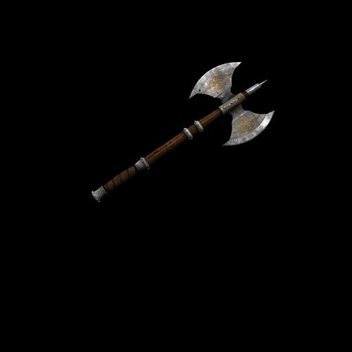

    Glossy Metallic Tests
    Default Glossy Metallic on top, AMRSAO Glossy Metallic on bottom
    2000 x 2000 - 97K
    2000 x 2000 - 102K
  • TheNathanParableTheNathanParable Posts: 1,089
    Just so you know, something which I learnt from making my Visual Style shaders, setting "Max Distance" to 0 disables Ambient Occlusion (as in, actual disabling...boosts render speed significantly). It's the preferred way of disabling Ambient Occlusion, as attempting to set the "Strength" to 0 ends up darkening the entire surface (unlike most 3d packages, that start with white and add ambient occlusion to it, Daz Studio works by starting with black and adding light to it...for some strange reason).
    Well, that's with the Shader Mixer version of Ambient Occlusion anyway, not sure if your version is different.
  • adamr001adamr001 Posts: 1,322
    Yup, thanks BT. I'd learned that lesson :) It's probably easier to just do it the way you said... I have been attempting a logic gate toggle... e.g., published variable with a value of 0 or 1 to either use the AO path in shader mixer or the non-AO path.
    Wasn't having great luck with that, so the Max Distance method looks like a winner. Now maybe I can get back to finishing these. :D
