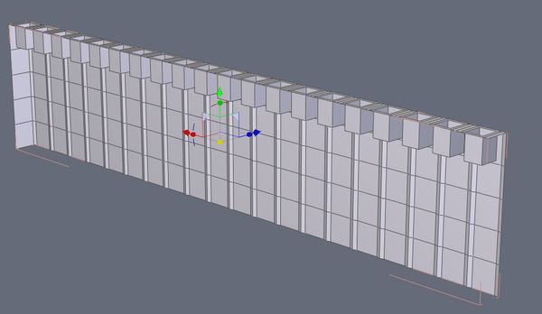

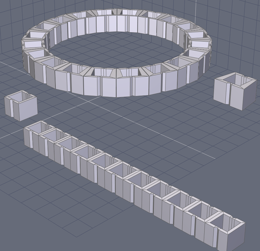

in image1, is an example of using the clone tool using the copy on support tool on a circle line to alter a singular part to get a desired effect and make the block fit properly. there is also an example of using multiple copies to create rows of blocks.

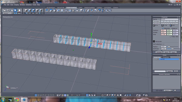

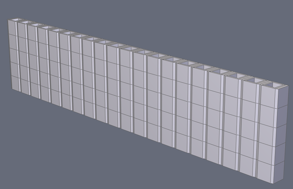

in image2 and image3, is an example of a single model from a grid. no multiple copies, no individual blocks. very efficient.

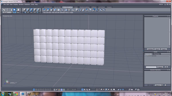

However, if you do use that method for the heck of it, be aware that when you weld into a single object, touching edges will weld, resulting in non-manifold edges, which are seriously bad. See that attached pic - the one with the blue lines has those non-manifold edges - the other had the sides removed before replicating, welded then the two outer sides put back.
