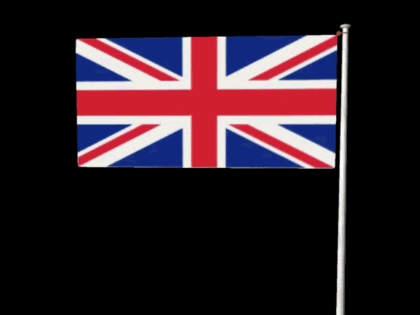

    Hi Msteaka,
    Glad you got this working.
    I tried a bit more (including an excursion into 3d painting to give the flag some colour) and got results which are not really much use but which show gravity pulling in two directions.
    I didn't make a flagpole and the 30*30 flag is quite small in the scene. I placed a standard cube primitive right beside it to show how small.

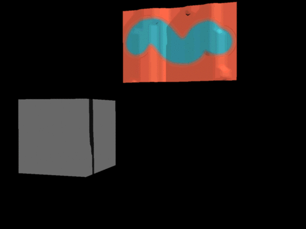

    Oh, and out of curiosity, to confirm whether settings of "0" are a problem with Bullet, here's an image of the exact same scene as the video I posted, the only change being that I set stiffness and bending for the flag both at "0".
    Never set "0" on simulation settings... :) :)

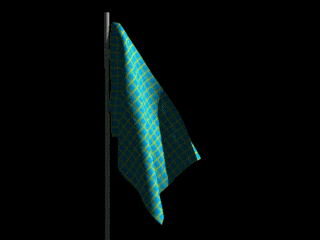

  • starboardstarboard Posts: 452
    Gentlemen,
    I did not realize what a contentious post I had launched.
    The reason I was having trouble was that I was following Phil's tutorial on flags. As you can see he has the settings for stiffness and bending at zero. Phil says " For cloth you probably want to set the stiffness and bending at zero" Could it be that there is a difference between Carrara 8 and 8.5. As you can see Phil is using what I assume is 8 and there is a difference in the arrangement of the sliders between the two. In Phil's tutorial the flag works well. So what is missing that I cannot get the same result ? I am just puzzled why it does not work for me at zero as Phil suggested ?
    Starbpardtack
    686 x 469 - 65K

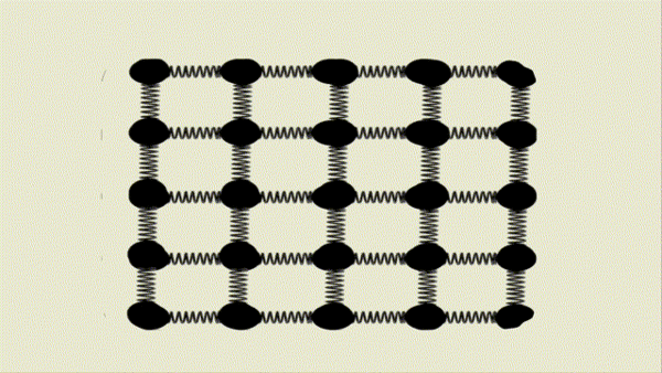

    As another example of the complexity and inter-relations of the cloth settings and parameters....
    Keep in mind the basic model being used my many/most cloth simulators:
    Take your cloth mesh and replace each vertex with a metal ball. And replace each edge with a spring. Now you have a physical model that is used to simulate your cloth...a mesh of weights tied together with springs. And the Density setting tells the software how heavy the heavy metal balls are. And the Stiffness setting tells you how springy or stiff the springs are.
    And now connect more springs that span multiple vertices, not just adjacent vertices. And the springy-ness or stiffness of those springs define how easy or difficult it is to fold the cloth, also known ans the Bending setting.
    So now just imagine your mesh of vertices and edges and faces is actually a big sheet of weights and springs. That's how it is modelled in the software.
    And if you understand that, you suddenly can understand how a more dense mesh means you have a lot more springs for the same size mesh. And suddenly the exact same Stiffness setting results in a much stretchier cloth SOLELY due to a more dense mesh. Try it sometime, BTW. Connect a few identical springs together, and you'll see that the result is a springier spring that with just one spring. :) :) :)
    But a springier spring also APPEARS like the metal balls are heavier, since they cause a more stretchy fabric. So are you certain that the increased stretch is due to a Stiffness setting, or a Bending setting, or a Density setting?
    And you can also suddenly see that since there are springs between adjacent vertices, AS WELL as springs spanning multiple vertices, the settings for Stiffness and Bending affect each other. So a Stiffness setting that works for one mesh might not work well at all for a different mesh, especially if it also has a different Bending setting.
    Post edited by JoeMamma2000 on

    Here's a simple animation to show the mass-spring model used in cloth sims. It's missing the Bending springs which span multiple vertices, but you get the idea.
    640 x 360 - 3M

    Well, after a night in the crypt and some morning coffee, I thought I'd look in again - and there are lots of new comments!
    Don't worry, Msteaka about contention here, talking about Carrara's soft body seems to get hold of some of us - heaven knows why! Unfortunately, I can't help with the question you are asking - Joe has more knowledge of it than I have.
    Joe, yep, I should have been thinking of divide by zero - but who knows if the physics calculation ever does such a thing? That's one more example of where I should go and do something more worthwhile instead of trying to figure all this out.
    A quick experiment before posting showed me (in 8.5 Pro 64 bit) that Volume does seem to do nothing. At least for a sphere falling onto a slab. Stiffness and Bending do affect how flat it becomes and how much it bounces back into shape.
    Speaking of the Carrara versions. Until a few weeks ago I was using the 32 bit version and needed to get a new computer - much to my financial regret. Now I'm using Windows 8 and Carrara 8.5 pro 64 bit, I've had problems rendering some physics simulations. I think PhilW put in a bug report for something similar.
    @Mythmaker, it's good to hear of your work on these issues. The more the merrier! I too, started from finding how easily physics worked in Iclone (version 5) and I tried to see if I could do the same in Carrara. It's been fun but ultimately somewhat frustrating...
    Joe, that illustration with springs and the explanations helps a lot also.
