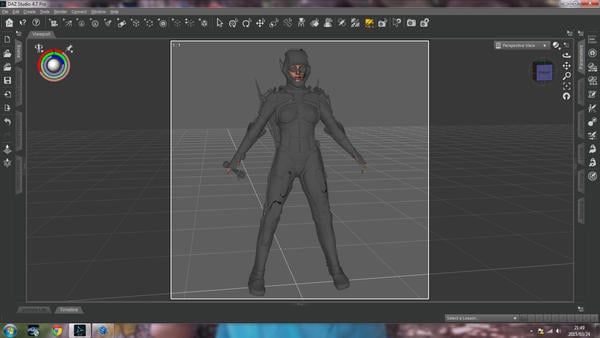

    My goodness, you have really set yourself a challenge - I would far rather model from scratch than try to convert :)
    Firstly, the mesh is well-constructed and there is nothing wrong with the original - although I hate working with tri's. I used the high poly model and it imports easily into both Hex and Studio. Sending the outfit with G2F over the bridge works and after removing the textures, there is no lag or any other problem. Possibly the outfit you are using became corrupted after all the trials you have made.
    The two figures are so disproportionate, that proportional scaling doesn't work and disproportional scaling distorts the outfit.
    If I had to do this, I would either rig Cia, or, more easily, morph G2F to fit the outfit. There are a lot of objects in there that I can't work out what they are intended to be - look like they are possibly armatures. I deleted those without any ill-effects.
    The challenge is to work out what parts of the outfit are made to deform with the figure and what are rigid, to move with the limbs, but not deform. Don't know how this is done in DS - in Carrara I would parent those to the appropriate limbs.
    In the attached pic, I scaled G2F to fit the outfit, although I didn't morph it, so the outfit doesn't move with the limbs - pokethrough is minimal after applying the smoothing modifier and can be easily fixed in Hex.
    1600 x 900 - 170K

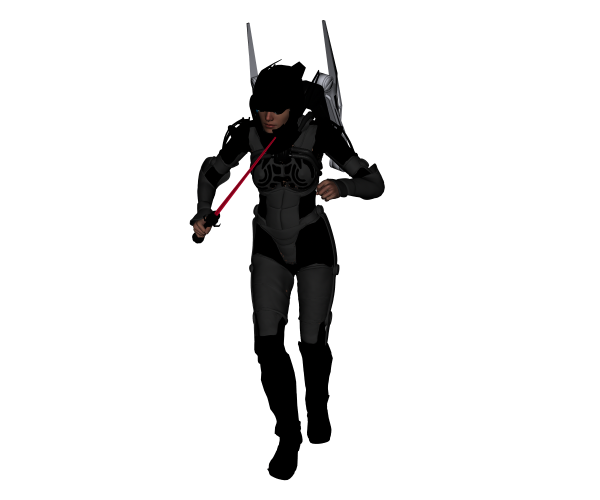

    Well here's what I got so far. Still needs some work (need to run the suit back through the FBX conversion as mesh smoothing still needs cranked up to 20 and the boots still need done. As well as adding control bones for the back arm claw things.)
    600 x 500 - 51K
  • RoygeeRoygee Posts: 2,247
    Looks like you got it sorted - well done:)
