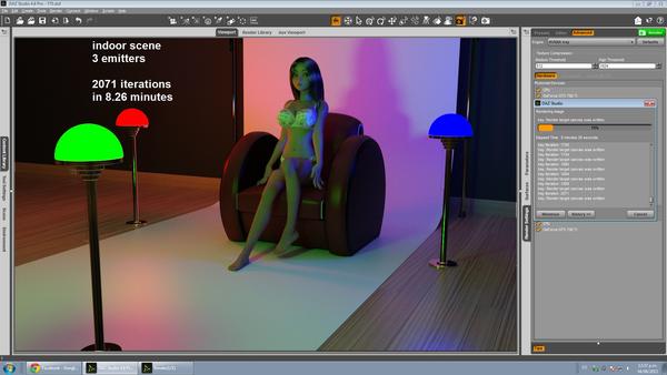

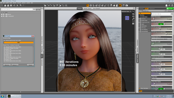

    Daz iRay Render Speeds is the title of the thread, well, I have numbers!, depends so much of the kind of light and the setup of iRay materials, and you don't need to reach 100% for achieve a decent render, the images speak for themselves:
    1920 x 1080 - 540K
    1920 x 1080 - 483K
    1920 x 1080 - 1M
    1920 x 1080 - 2M
    1476 x 1080 - 888K
