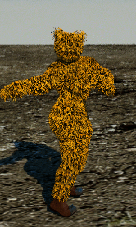

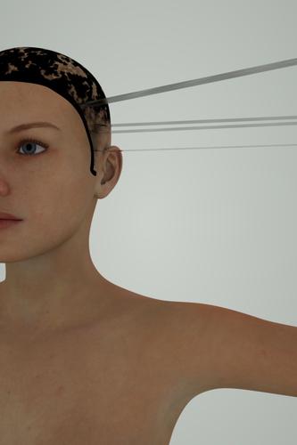

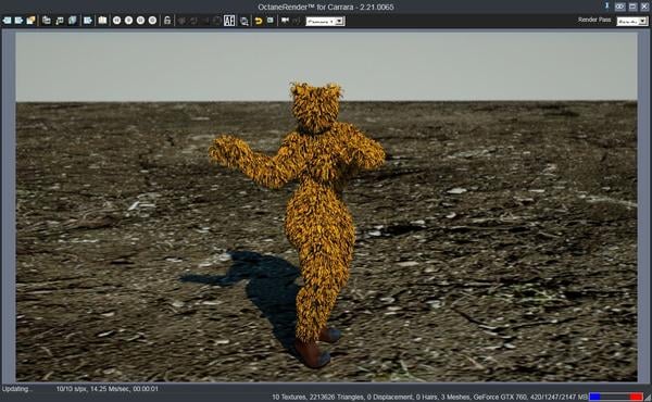

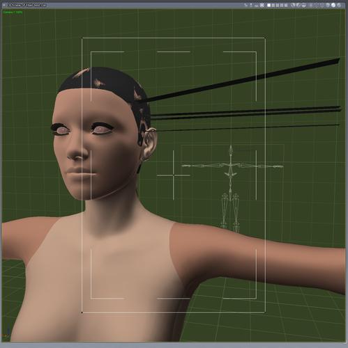

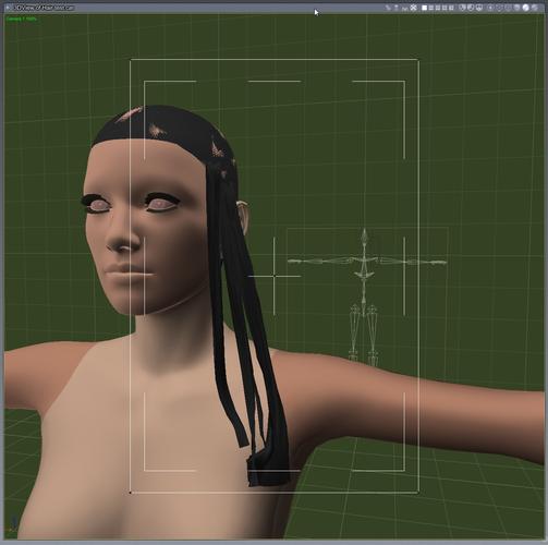

Hello there!
Today I tried this:
I took the Carrara G2F Scull Cap
Put some Vertex rectangles to it
Attached hair material
Started the Carrara Physics
Renderd in Octagon.
Got Carrara Dynamic Hair (ok, not quite ;-) )
358 x 226 - 23K
1305 x 1307 - 166K
1306 x 1297 - 158K
640 x 960 - 48K
640 x 960 - 52K

    So that is actually Carrara's dynamic hair, and not a vertex geometry? I thought external renderers couldn't use it, because it is a render time effect.
  • EddyMI3DEddyMI3D Posts: 365
    edited March 2015
    It actually IS vertex geometry. For Carrara Hair can't be seen in Octane and Luxrender Co.
    I made this try, because I miss dynamic Hair wit Octane.
    Fiber Hair work fine with octane, but LAMH does not work with Carrara O.o
    Post edited by EddyMI3D on

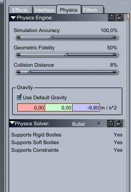

    I use bullet physics
    258 x 377 - 23K

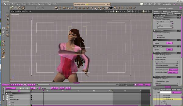

    yes was dynamic just not welded, have had similar issues in Poser clothifying hair
    the problem is selecting the base of the strand flaps to pin/make rigid unchoreographed etc when obscured by other mesh.
    I am using readymade DAZ hairs, if you model your own you could precreate groupings I imagine to add to named vertex group for attaching
    the main trouble is it is excruciatingly slow to calculate and does nor stop hitting esc so lose the lot trying,
    I am thinking exported cloth hair from Poser might be a better choice after all.
    this one so far is working but too early to tell, will take hours and hours, quite frankly easier to pose it with morphs on the timeline :lol:
    1501 x 873 - 304K
    1493 x 885 - 306K

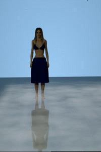

  • JonstarkJonstark Posts: 2,738
    Eddy, very interesting idea, but I think once you add a clothfied section for each hair you're going to be looking at tremendous calculation times for simulations that might make the technique prohibitive (not to mention it will take a long time to add all the hair cloths to the cap too).
    On the other hand, I've had very good results simply using Carrara's regular dynamic hair in animation, rendering it in a multipass with a hair and shadow pass, and simply compositing it onto the Octane animation. Here's a quick example (also composited in some Carrara fog on the ground too). Kind of an ugly little animation, but it was a proof of concept of matching Carrara hair into an Octane animation.
    200 x 300 - 8M

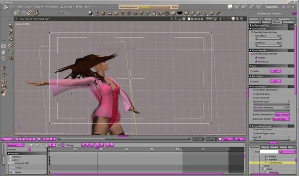

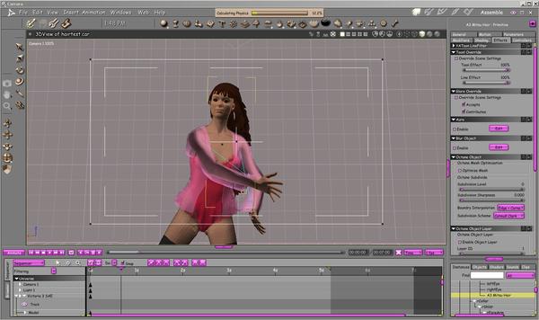

    it places 0 objects on the hair but selecting something else then hair it replicates at roots but wildly translated so it must detect the hair but not be able to coat it as such its full length and why translated?
  • WendyLuvsCatzWendyLuvsCatz Posts: 41,492
    anything grows is shaping up to be my dynamic hair for Octane alternative, it has gravity at least
    1920 x 1080 - 4M

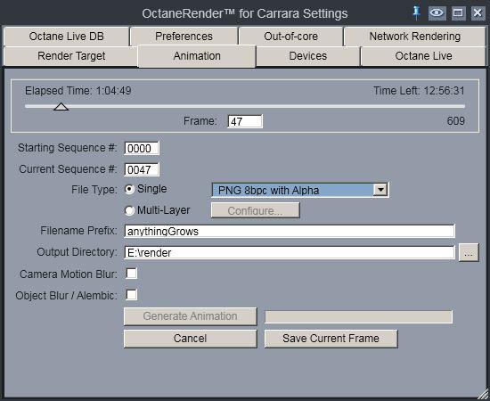

    a quick ani
    movie series of 600 full HD frames will take 12 hours
    1208 x 745 - 194K
    550 x 450 - 47K
    270 x 450 - 8M
    https://youtu.be/nqSxKcfuLN4 it stopped rendering at frame 112 oddly
    this is looped
