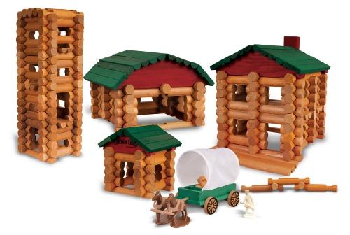

  • DaWaterRatDaWaterRat Posts: 2,887
    You guys never played with Lincoln Logs?
    Not saying that the fort is perfectly accurate or anything, but the structure is possible
    500 x 336 - 60K

  • wizwiz Posts: 1,100
    Yes. And more than the creator of the fantasy fort did, apparently.
    Look closely at the Lincoln Log structures.
    Notice how the east-west logs start with a 1/2 log, and all the north-south logs are 1/2 log higher than the east-west logs. That is what is possible, and what the creator of that fantasy "fort" did not do.
    There's also the issue of the substantial "roofs" on the four turrets, where the weight of a bunch of full logs is born by two 1/2 logs, and it really can't connect to the uprights.
