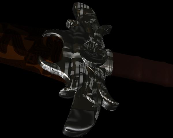

Why are the ornaments gone when a Shader is added?
Is it possible to add a Shader without losing the ornaments?

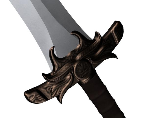

    if I do this, it would show the ornaments but only partial and the Shader is applied only partial, too

    their a 4 material zones; Blade, Guard, Grip, Pommel. I select the needed one bevor adding a shader. To add a shader is not the Problem as you can see at the first Picture. The Problem is that all ornaments are gone after adding a shader or the ornaments are gone partial and the shader are added only partial when I use Ctrl while adding a shader.
    The one I use for the Guard is The Shader is Metal - Worn - Real Reflections from http://www.daz3d.com/supersuit-heavy-hitters,
    it works for the whole Guard when I did not use Crtl while adding it (first Picture) but doesn`t when I use Crtl

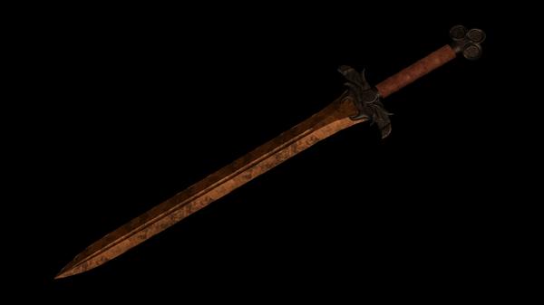

    The Shader Preset you are using uses tiling, the image maps are therefore tiled, when you leave them in - you can try reducing the tiling back to 1 and see how it looks.
  • R25SR25S Posts: 595
    That`s it; with UV Tiling set down to 1 it works perfect - again, I`ve learned something new.
    Thank you.
