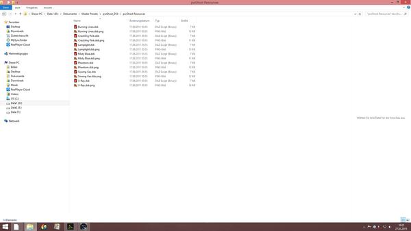

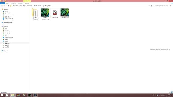

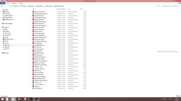

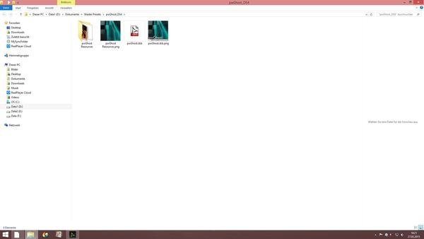

    to find the installed pweffects go to the Content Library (to the pwShaders), do a right click on one of the Shader Icons, their will be a
    Popup window, select "Browse To File Location", then a window will Pop up wich is the Location of the pweffects.
    Or schearch manually;the Location should be something like C:\Documents\Shader Presets\pwEffect_DS4\pwEffect Resources

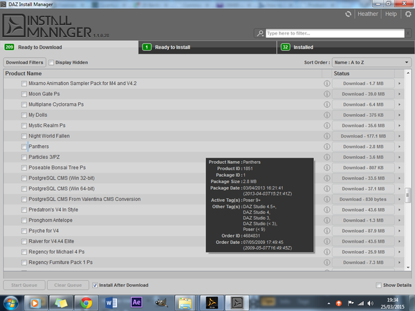

    I checked that the plug in was checked off and it is. Attached screen grab of the product downloads available and as you can see it is not listed. I know how to find it on my computer and what the run path is and it shows up in Daz Studio, but the problem is that doesn't help me uninstall it. Thanks for all the suggestions so far.

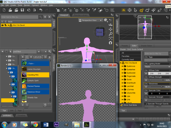

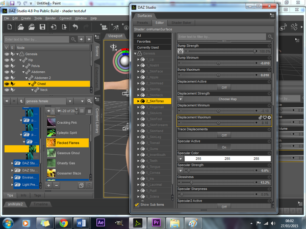

    and here is an example of me selecting surface and object
    1024 x 768 - 233K

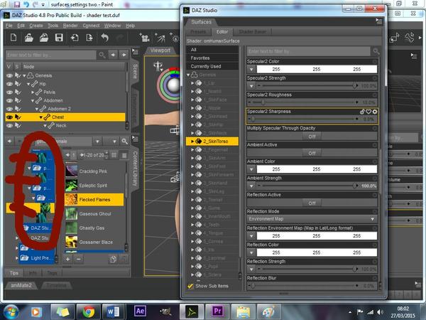

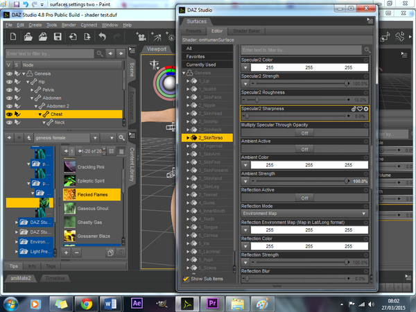

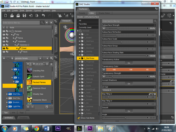

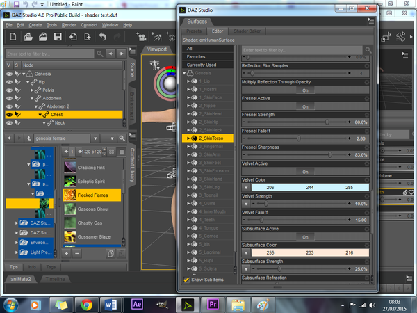

    this is how to add the shader (as I said before)
    1868 x 816 - 195K

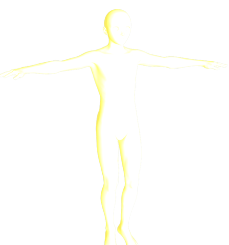

    Another strange thing thats happening is that I tried to apply various pwEffect shaders with the same renders but about half came out completely white with only one or two having some colour but not looking like the examples in the product sold so I assume something is wrong.

  • R25SR25S Posts: 595
    how did you add the shader and wich reder engine do you use?

    @ R25S thank you for your image. This is in fact what I am doing correct? See image above in thread...

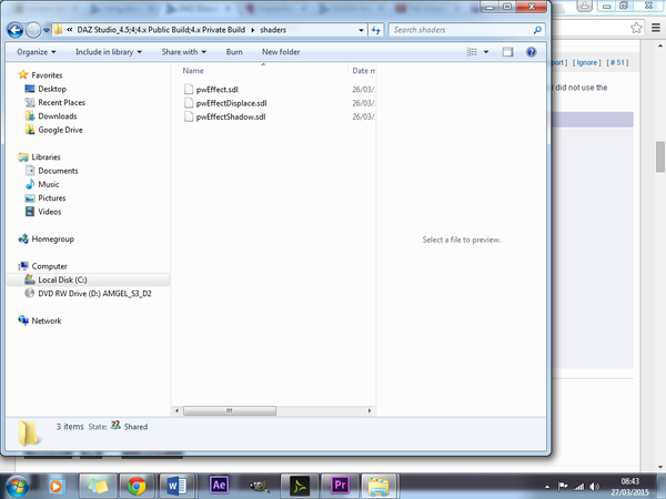

    @ R25S I do notice from your screen grab that yours say shader over the image and mine don't. Also when I look at it in the render settings tab after I have applied it still says default instead of pwEffect shader
    You mean the Surface tab? In the Render Tab they didn`t show Shader for me.
    Before adding a Shader the Surface Tab Show "Shader they don`t show Default.
  • edited December 1969
    To Clarify under your contents tab, the effect has shader written in the corner and mine don't. I was also noting that under my render settings under render style it says shader: default (despite having applied the pwEffect shader and I read that if it has been applied then it should name the shader not say default as it does.
    It also does not come up in the shader list under render settings. The only options are default or cartoon.

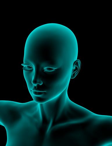

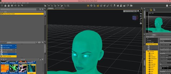

    edited March 2015

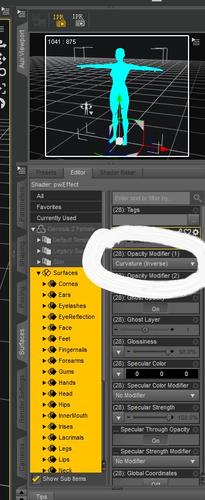

    Just an Idea... in Surface Tab / Currently Used / what is your Opacity Modifier? The wrong Modifier can cause your figure to render white.
    here instead it renders light green
    1047 x 881 - 52K

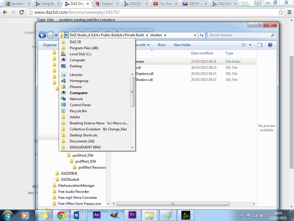

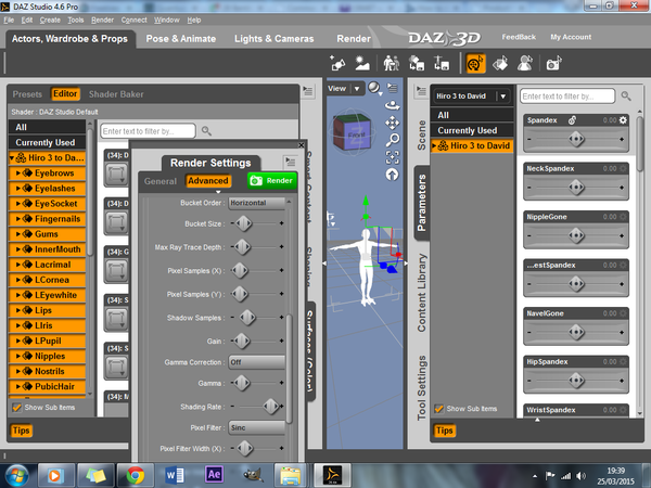

  • edited March 2015

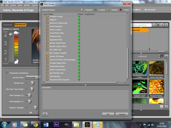

    I don't see a setting for opacity modifier even under advanced settings in render settings? There is a multiply specular through opacity is that the one you mean. You can only turn it off or on...Also do I need to bake before I render?
    I also notice then when I select help and view installed plugins pwEffect is not listed there.
    1024 x 768 - 335K
