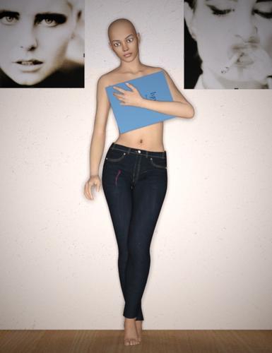

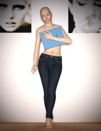

Render 1 - Settings above
Render 2 - Light Disc Height/Width 10
Render 3 - Camera Scale 50%
Render 4 - Spread Angle 20

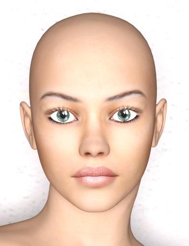

Render 5 - Head shot - Focal Length 200mm / Lumens 7,500
All render times - Approx 25 secs

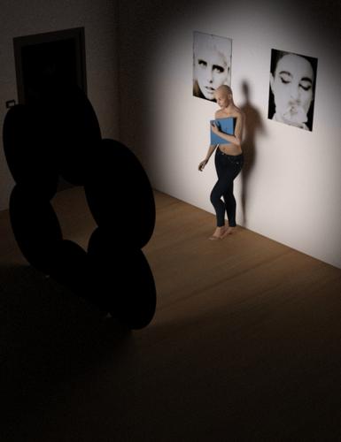

  • macleanmaclean Posts: 2,438
    Here's the pic of the setup.
    mac
