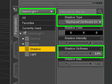

    This may not speak directly to your point, but one thing that can be done for more realistic shadows from a distant light is to set the Shadow Softness to something like 1 to 2 percent, and be sure to use Raytraced Shadows. This diffuses the shadow's edge the further away it gets from the object casting it.
    FWIW, the new Iray renderer (now in beta) does a beautiful job with realistic shadows in my opinion...can't wait for that to be released.
    428 x 322 - 39K
