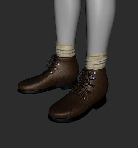

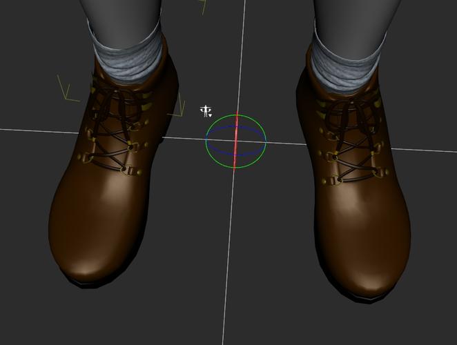

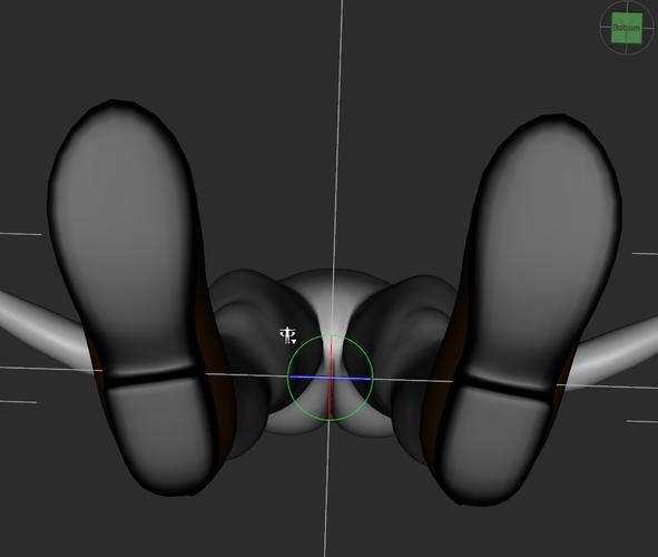

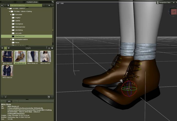

    Thanks again folks. graham james your technique works, at least for flat wear or sort of flat heels. This set is from the Miss DeeAnna J set. Used Shaders to texture it to see what would look good. Mixture of the Super Suit and Mach Pack for the socks. Quite happy, no funny mess to deal with. I'm sure if there are morphs in the laces.... well anyway, no big deal. LOL
    Took me a bit of work till I was happy with the leg and foot position for V4 but I got it just right I think. I then saved that out as a new scene file to load up with Genesis if I want to do other pieces.
    The Transfer tool is doing better too I think. I did add a smoothing modifier to it as it helps to get things "popped" into place better when conforming.
