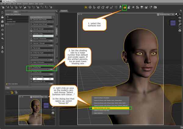

    If it turns out not to be mismatched UVs, it might be an issue with the SSS skin shader. If that is the case, I've seen some ways to try and deal with it:
    1. change your distance from the camera to the model (i.e. zoom in) and try re-rendering
    -- or --
    2. lower the shading rate in the render settings to something like .5 or .25 (the lower the shading rate, the more detailed/sharper your render usually appears)
    --and if that still doesn't help--
    3. Lower the shading rate in the Surfaces pane for all surfaces that share the same group ID # as the skin. I believe you have to do that for ALL surfaces that share the same group ID#, whether or not the artifact shows up in those surfaces or not. It may also be that the shading rate should be identical in all those surfaces. See attached .jpg for how you might go about doing that...
    1529 x 1080 - 327K
    Post edited by bitwelder on
